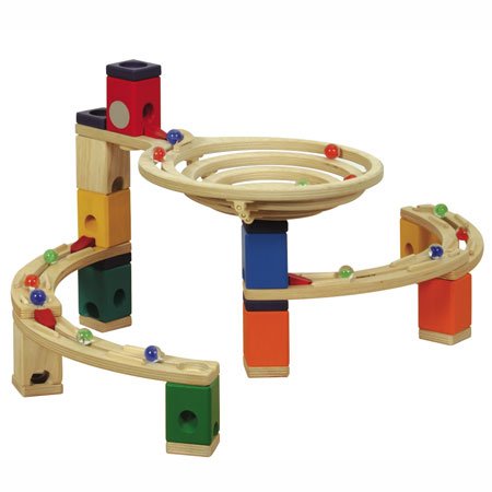

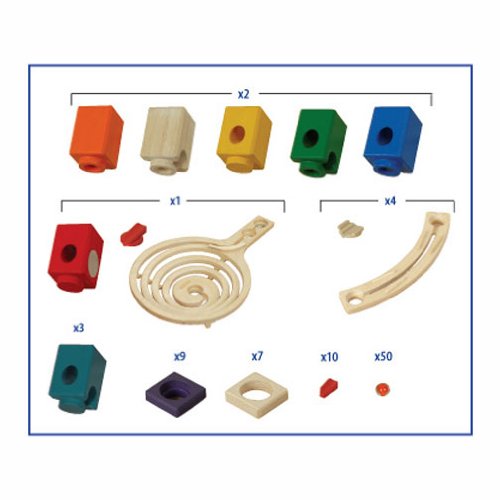

Pennview:
Thanks for that link - but I am looking for something similar to the Quadrilla Basic Ball Racer set. Something that the kids can disassemble and modify, and I can make more parts as needed. It seems if someone in China is making these, they got the idea from someone in the USA, and I ought to be able to reverse engineer it. The trick will be the inter-connections, and making them work at the angles so the ball keeps rolling. I'll take a trip to ToysRUs and see one in person, then I can think better how to get it made at home. Wood is cheap, it's the time factor now that has me in a bind.

I second the idea to get a copy of "Woodcraft" magazine - Volume 8/No 44 Dec/Jan of 2012. There you will find complete plans of how to build such a set. They use a 3/4" R cove bit with a 3/4" bearing. Also a 1/8" roundover for block edges and a 3/4" Forstner bit.
They also have plans for a carrying box for the blocks.
They use 5/8" marbles.
