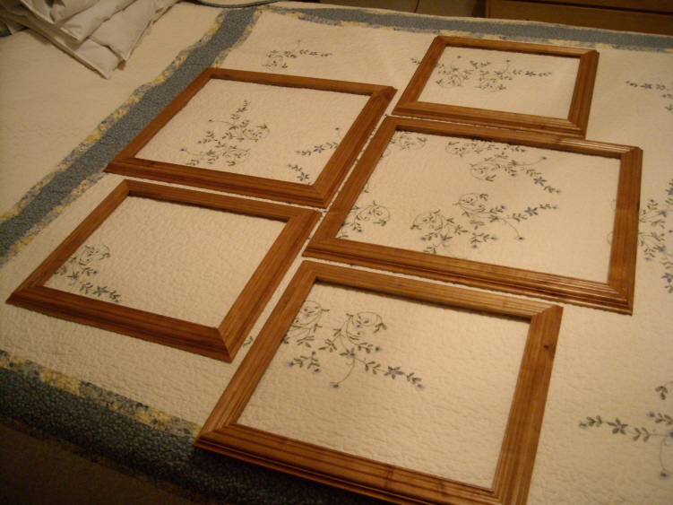

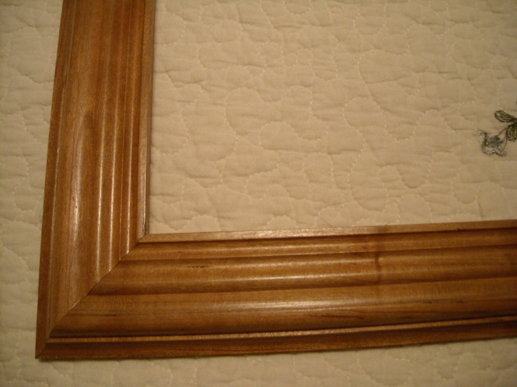

I just completed some cherry frames for my daughter to hang her college diplomas. I used two different router bits to shape the molding, one next to the other so they slightly overlapped.
The first bit was I used was made for picture frames and the second bit was just a roman ogee.
I used two different bits because just using the picture frame only bit did not provide the profile I was looking for. The ogee around the outside edges gave the frames a certain amount of depth, and I think they turned out good considering this was my first attempt at making picture frames.
I finished them with two coats of satin Deft clear wood finish.
frame 1.jpg (262.96 KiB) Viewed 1934 times
frame 2.jpg (228.17 KiB) Viewed 1907 times

Welcome to the forum. Nice tight miters!

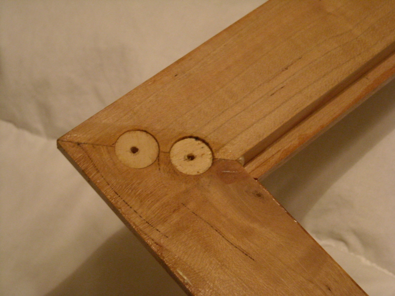

The actual miters were done with my vintage Craftsman Radial 100.
I did not move my blade angle once I established a 45 deg cut during the saw setup.
I made some trial fits with some scrap pieces and verified the fits were good.
One thing I found out about making good miters is you must make the opposite parallel pieces of the frame exactly the same length, I used a simple stop block on the saw to duplicate a given length.
The joints themselves are just tite bond glued with two 1/2" diameter thin plywood cutouts that bridge the joint to add the extra strength. I posted a pic of the joint from the backside.The hole in the middle of the bridge is a bleed hole for the glue to squeeze up through when pressing down the the joint. Without that hole you with have an air pocket under the bridge.
frame miter.jpg (263.4 KiB) Viewed 1864 times
