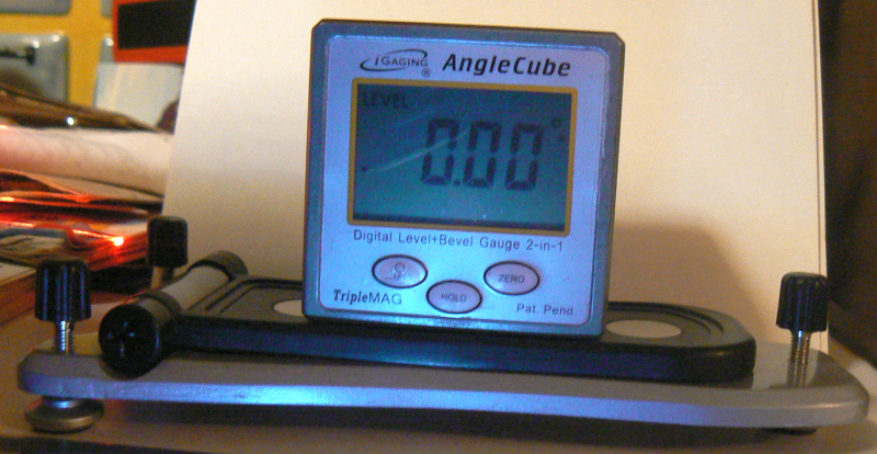

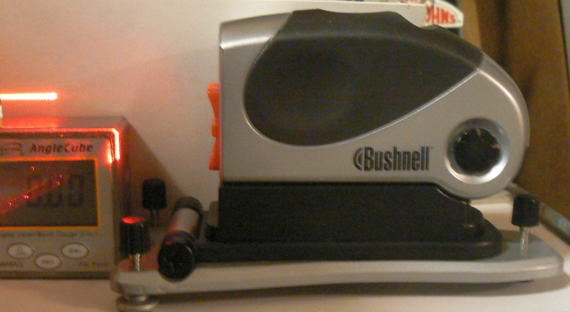

Not the same as Dusty's, but similar design. The base also has a hinge on the front which allows it to project lines below it.
[ATTACH]15368[/ATTACH]
Set it up on a known level counter and set front to rear with igag.
[ATTACH]15369[/ATTACH]
Left to right was adjusted after mounting on to base. The front to rear was not altered.
[ATTACH]15370[/ATTACH]

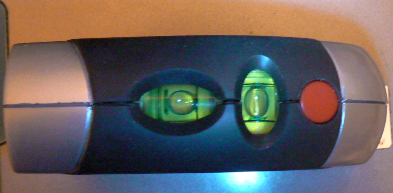

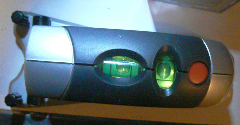

The lines projected(cross hair hor/vert) were correct(at least purty good for spirit level setting). The left to right vial is accurate, but the front/rear vial places the bubble near the rear line when base is level ala igag. The splitters were in agreement on the projected horizontal line.
One thing I do not like, is the laser itself although tightly secured by magnets in both the base and the level, does deflect some when pushed on the front. This is the result of no definite stop for the back hinge(the laser is hinged on the back, and the base is hinged in the front. That allows projecting hor line either below or above the laser.

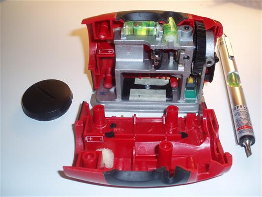

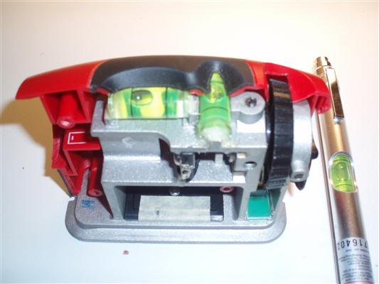

It is not in my nature to give up; at least not until I have destroyed any opportunity to "fix it".
Having sorta given up, I decided there was nothing to be lost by tearing it apart - in an attempt to fix it. I have torn it apart and I have a plan for fixing it but I cannot complete the job until I find my tube of syllastic (sp).
I stated earlier that if the viles were adjustable, this would be a pretty decent tool (for $30). Well, they aren't exactly adjustable but I'm going to adjust it (the one that is way off). The viles are glued in place at the time of assembly; probably at the time they are installed and adjusted.
I very carefully pried the suspect vile out and I will now reinstall it and adjust it as it should have been.
Getting it all back together without breaking anything is all that remains (once I find the syllastic).

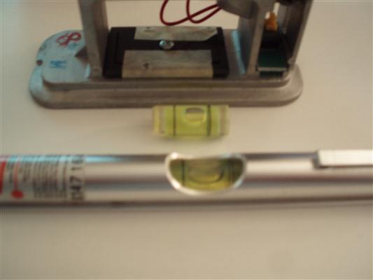

Simpler 'Solution'
Mine would not relinquish the vial, so -
[ATTACH]15381[/ATTACH]
I have made my peace with it.
As has already been said, absolute accuracy not relevant.
Problem is, it can be(the laser projects a very straight 'line').
P.S. The vial 'calibration' matches the laser - the base be damned!;)
