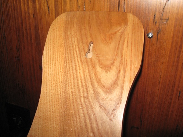

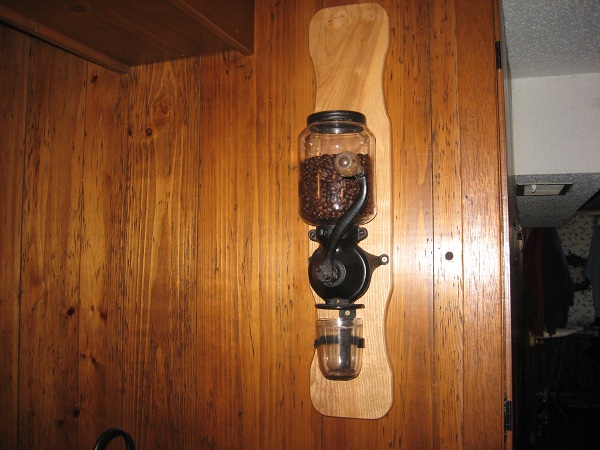

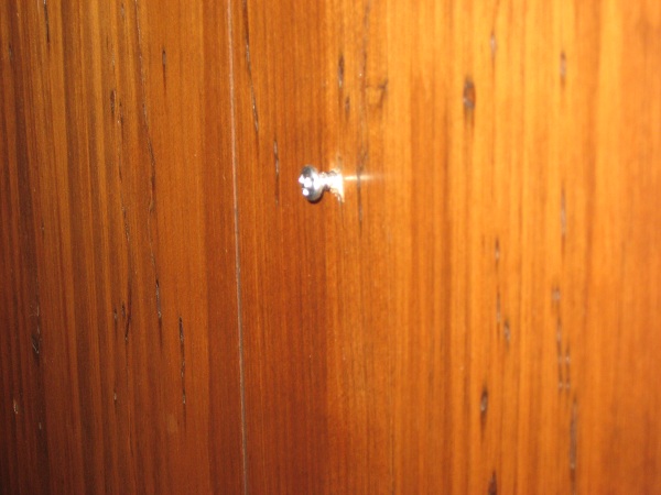

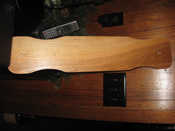

key hole mount
As pennview has said. this is pictures of how i mounted a coffee grinder to wall. solid as a rock....[ATTACH]15625[/ATTACH]
[ATTACH]15626[/ATTACH]
[ATTACH]15627[/ATTACH]
[ATTACH]15628[/ATTACH]

- IMG_2221.JPG (106.71 KiB) Viewed 2445 times
- IMG_2222.JPG (93.72 KiB) Viewed 2445 times
- IMG_2223.JPG (99.49 KiB) Viewed 2445 times
- IMG_2225.JPG (76.39 KiB) Viewed 2444 times
