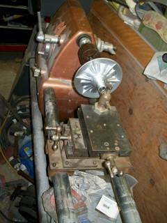

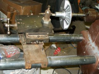

I find that it is craftsman, not the tools that produces great results. I have several metal lathes that I use for a specific function. I also have a Gilmer (Greenie) Shopsmith that I have several metal lathe chucks that attach to the arbor. I am able to use the Shopsmith lathe for very precision work (+_.001 runout) such as boring the control sheave end for deeper bearing location so I have room to stake the bearing. It is all about knowing the capability of your tool and how to use it to its fullest advantage.
[ATTACH]16235[/ATTACH]
[ATTACH]16236[/ATTACH]
With a dial indicator and sometimes shims, I have always had great accuracy doing metal work on this Shopsmith. I am sure it would be able to do the same for any woodworking tasks.
