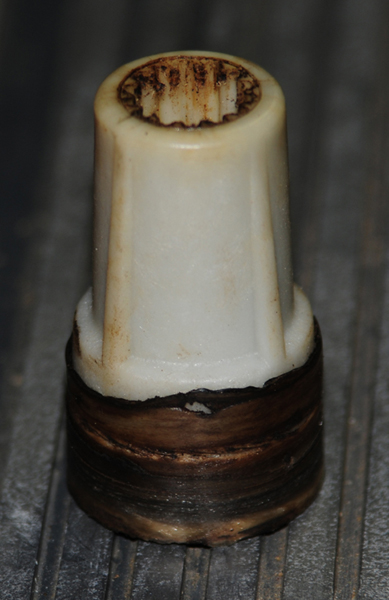

Took apart the quill and finally got the plastic drive assembly pulled out of the quill. Picture attached. It has gotten hot as you can tell the plastic was hot enough to flow a little bit.
- STUCK PART.jpg (153.97 KiB) Viewed 1629 times

That is one for the stupid PO tricks!!!:eek:aloibl wrote:Took apart the quill and finally got the plastic drive assembly pulled out of the quill. Picture attached. It has gotten hot as you can tell the plastic was hot enough to flow a little bit.
At this point, I would plan on changing out the idle shaft bearings. That much heat had to do some damage.
Stupid is when you think about it and then do it anyway. Ignorant is when you did not know better than to do it. I prefer to think the PO was ignorant of good machine practices.
We all start equally ignorant and then become less so as we learn from our mistakes. The brilliant amongst us have just been exposed to more learning experiences.
