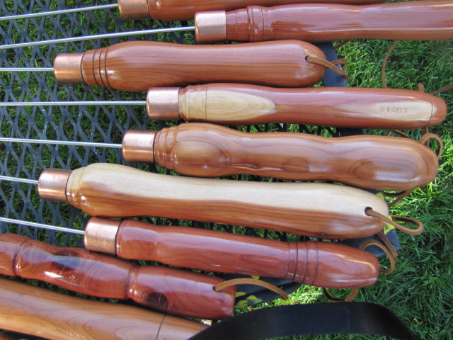

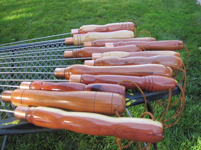

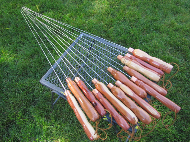

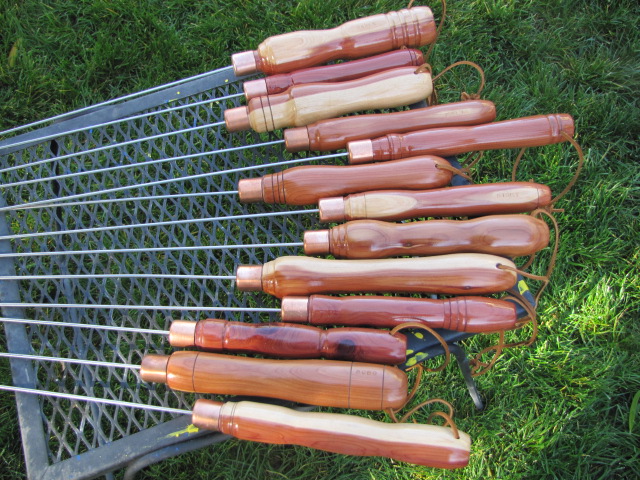

I posted these on the Gallery, but I was reviewing sharpeinng tips and thought I'd put them here.
Family fire pit roasters. One for each member of the family, but I need to do 4 more for the smallest grandkids and a son-in-law? if he ponies up.
[ATTACH]14574[/ATTACH]
[ATTACH]14575[/ATTACH]
[ATTACH]14576[/ATTACH]
[ATTACH]14577[/ATTACH]

mrhart wrote:I posted these on the Gallery, but I was reviewing sharpeinng tips and thought I'd put them here.

Those are awesome. We camp and cook out all the time and I would love to make some of these. What are the "stick" ends made of wire or something stonger and are those brass bans around the ends. I would love a plan or description if you had them.

futralwoodworks wrote:Those are awesome. We camp and cook out all the time and I would love to make some of these. What are the "stick" ends made of wire or something stonger and are those brass bans around the ends. I would love a plan or description if you had them.
Matt:D
The wire is stainless steel welding rod, refrigeration copper fittings for the ends.
