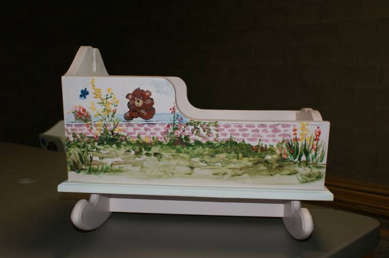

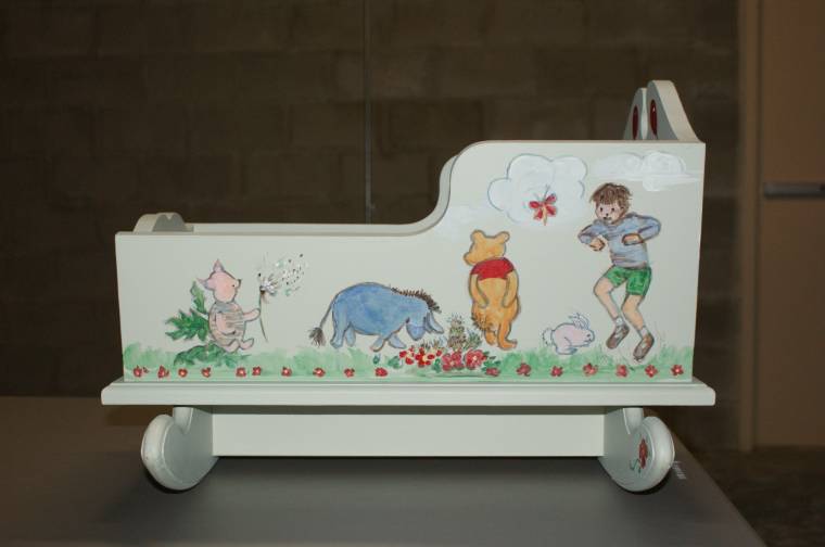

These children's items are good for skill building and make useful toys as well.
The following tools and techniques are used for building them.
Cross cutting. (table saw)
Bevel rip cuts. (bottoms of the sides)
Angled cross cuts (headboard and footboard)
Bandsaw (for the sides and end boards)
Drill press for all the holes.
6X48 belt sander for the rockers.
drum sander for the inside curves of the rockers
Router function for the details of the rockers and the bottom.
And also a host of measuring and layout skills that can be developed as a result.
A fair amount of planning of the work sequencing is also required as is the case in all projects. Try one and you will see what I mean.
We will be using these projects as a skill building class for our woodworking club in our retirement community.
[ATTACH]17745[/ATTACH]
[ATTACH]17746[/ATTACH]
BIll V

- bear on a garden wall.jpg (82.93 KiB) Viewed 1684 times
- winnie the pooh 1.jpg (80.13 KiB) Viewed 1684 times
