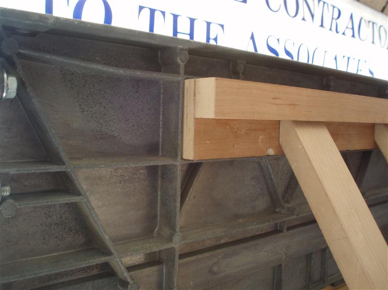

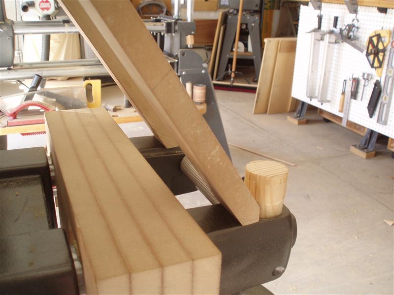

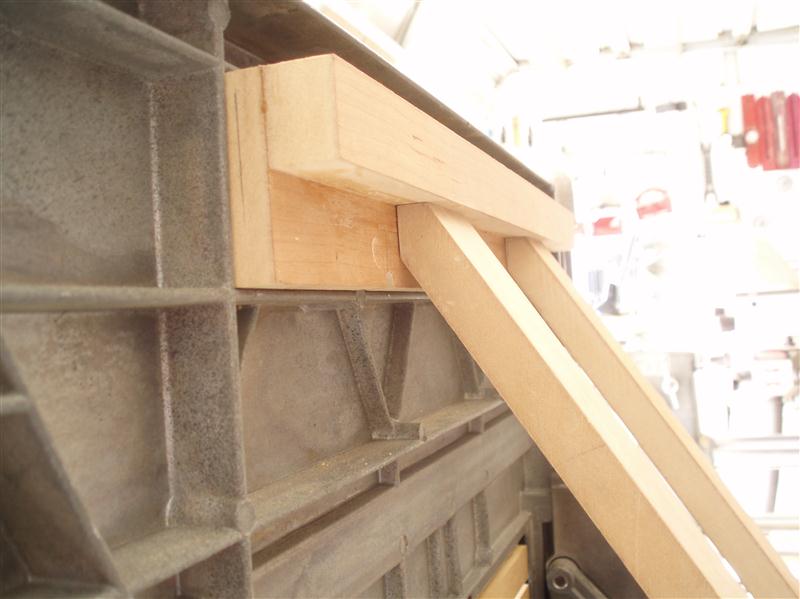

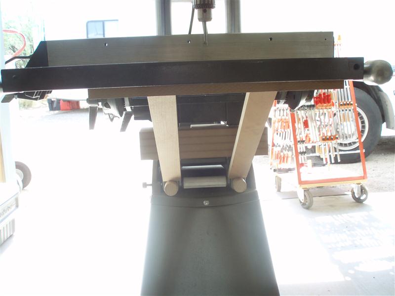

A New Jig 'Necessitated' By My Shorty
Concept changes to that jig:
Based on my concerns for the table be stressed and general comments from the forum, I have changed my jig. I think the attached images tell the story.
[ATTACH]17960[/ATTACH]
[ATTACH]17961[/ATTACH]
[ATTACH]17962[/ATTACH]
[ATTACH]17963[/ATTACH]
I do intend to replace those two braces with a wide panel. I did not have cut offs that would work so that will have to wait until after the next furniture project.
