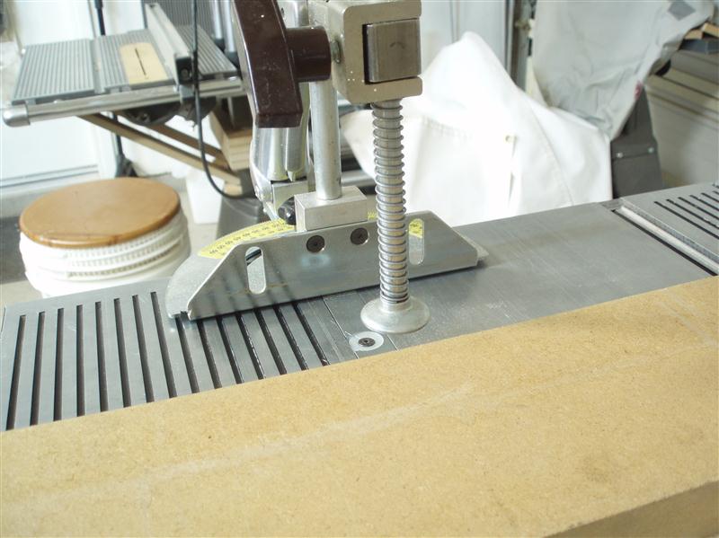

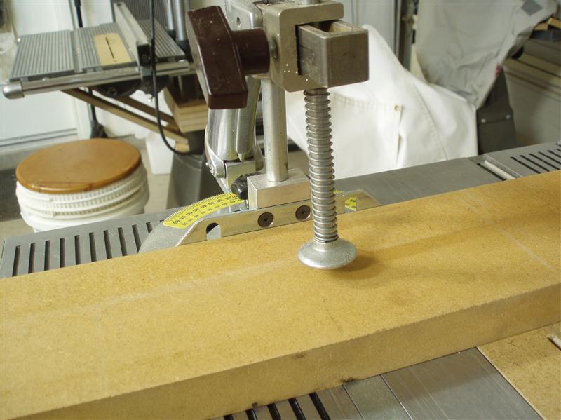

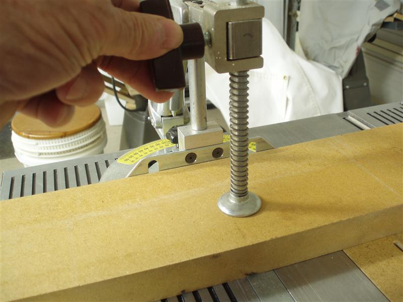

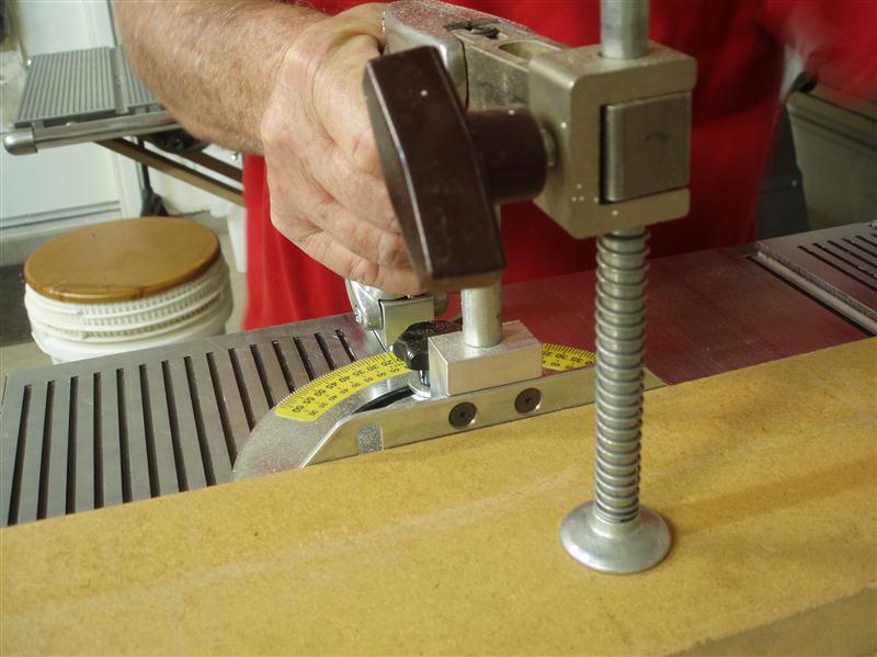

I have modified mine by adding a spring. The spring makes the adjustment for me; all I do is position the wood and release the knob which allows the spring to apply pressure top the foot. Once the foot is in place, tighten the knob. From then on, squeezing the handle applies the pressure that holds the work piece in place for the cut.
[ATTACH]17985[/ATTACH]
[ATTACH]17986[/ATTACH]
[ATTACH]17987[/ATTACH]
[ATTACH]17988[/ATTACH]
- Safety Grip 001 (Custom).JPG (69.01 KiB) Viewed 2341 times
- Safety Grip 002 (Custom).JPG (63.2 KiB) Viewed 2333 times
- Safety Grip 003 (Custom).JPG (68.52 KiB) Viewed 2335 times
- Safety Grip 004 (Custom).JPG (67.39 KiB) Viewed 2336 times
Warning Off-Topic Questiondusty wrote:I have modified mine by adding a spring. The spring makes the adjustment for me]17985[/ATTACH]
