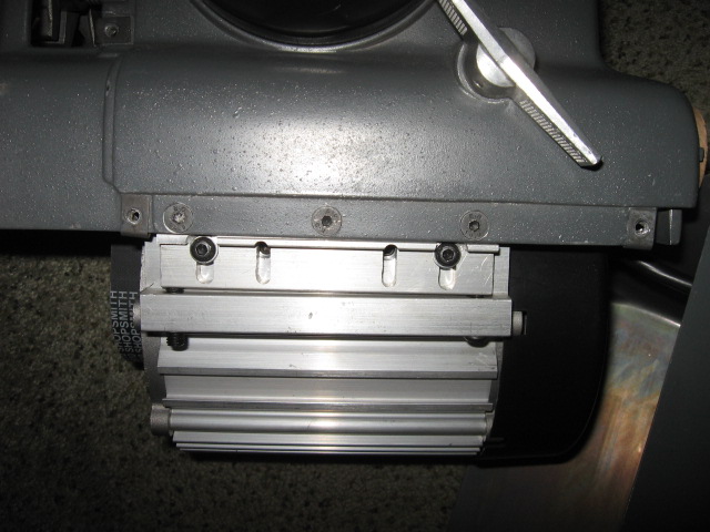

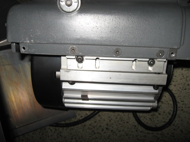

I'm including a couple of pics. One of each side of the motor on my first PowerPro headstock upgrade. Hope it helps. If you have any questions, please ask.
- IMG_1134.JPG (99.31 KiB) Viewed 1643 times
- IMG_1135.JPG (98.51 KiB) Viewed 1637 times
