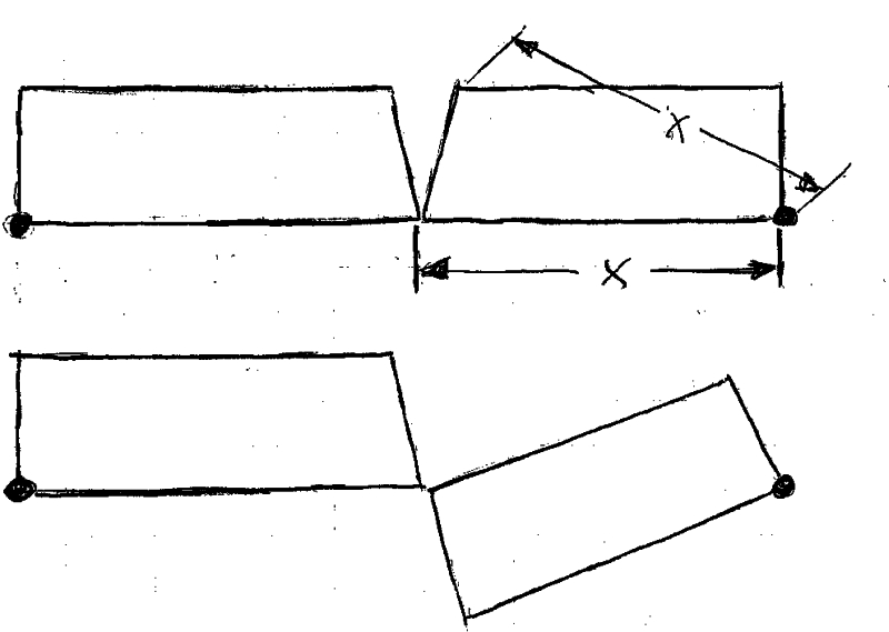

The thickness of the door and the swing width determine the necessary bevel angle. The distance from the hinge pivot to the back edge of the door must not exceed the distance from the hinge pivot to the opposite door front edge.forrestb wrote:I watched Sellers' video from start to finish. If he pegs the tenon, fine. Otherwise where does the glue go in such a tight fit (hammers it on???)?

Might it be possible to get a sketch of the above? I think I get it but a sketch would confirm what I think I now know about this issue. Thanks for all you do for this forum. I for one, and I'm sure others, have gained a lot from your posts. I appreciate the time and effort you put into the posts you make.JPG40504 wrote:The thickness of the door and the swing width determine the necessary bevel angle. The distance from the hinge pivot to the back edge of the door must not exceed the distance from the hinge pivot to the opposite door front edge.

fixit wrote:Might it be possible to get a sketch of the above? I think I get it but a sketch would confirm what I think I now know about this issue. Thanks for all you do for this forum. I for one, and I'm sure others, have gained a lot from your posts. I appreciate the time and effort you put into the posts you make.
[ATTACH]19544[/ATTACH]
- door bevel.jpg (66.99 KiB) Viewed 2705 times
