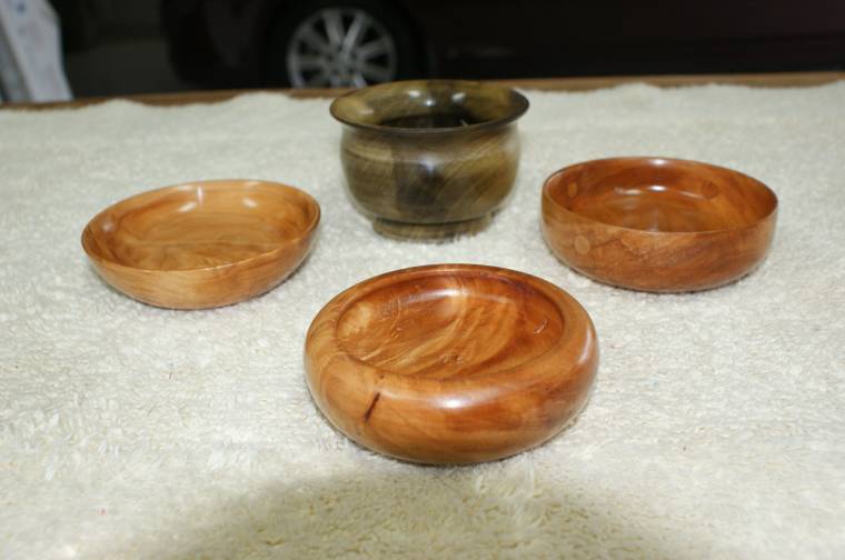

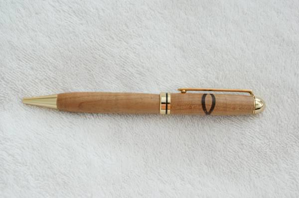

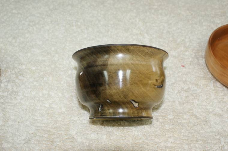

I have turned a bunch of pens and lately I have been turning some bowls and my next step will be doing some segmented turning.

[ATTACH]19503[/ATTACH]
[ATTACH]19501[/ATTACH]
[ATTACH]19502[/ATTACH]
Bill V
