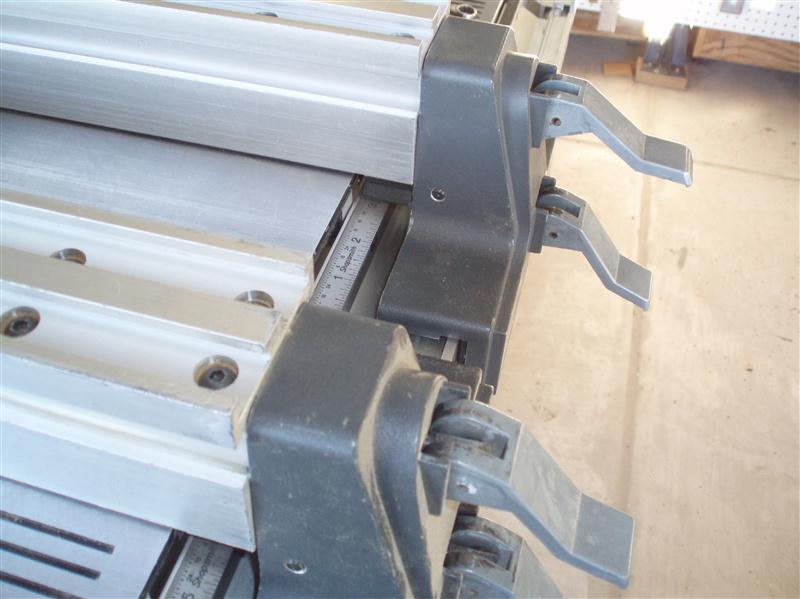

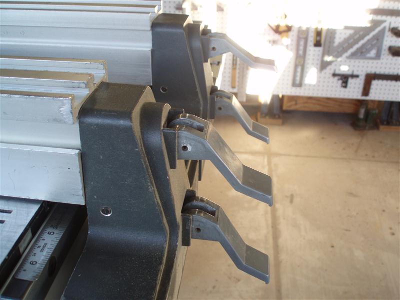

Sounds like your lock position of about 4 o'clock is about where it should be. For reference on my machines, both the upper and lower levers are approximately parallel to each other. Also there is a flat on the bottom of the cam end of the lever. The flat is approximately parallel to the ground.
The key is the fence locks hold the fence and when the front one is locked down it pulls the fence square.
Rob in San Diego

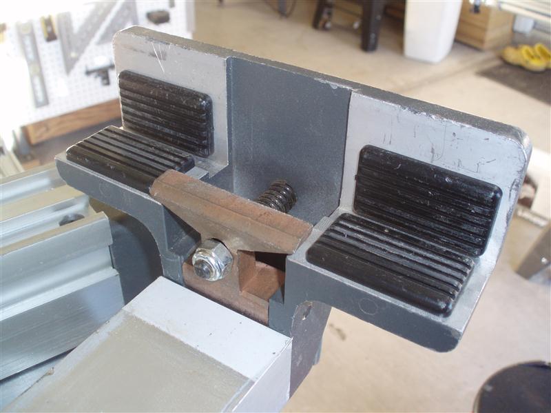

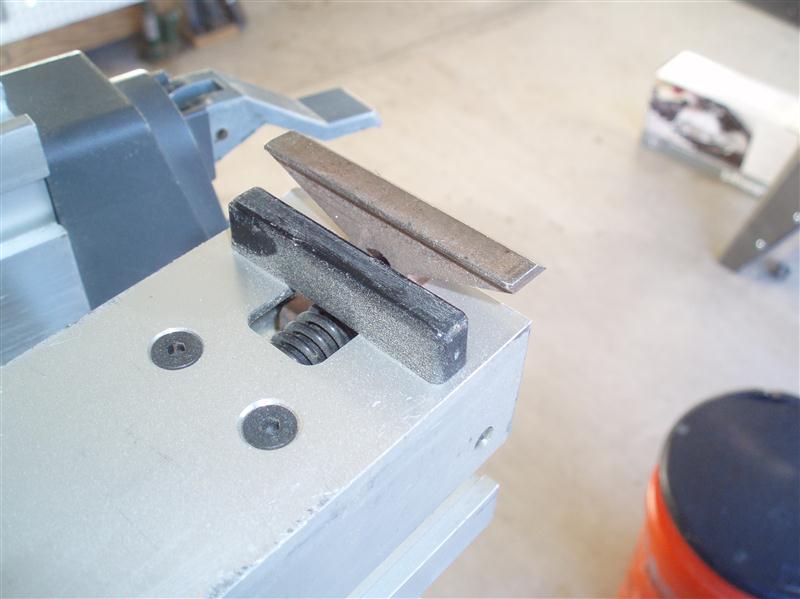

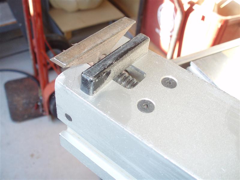

I have the convenience of two fences both adjusted independently by myself. Evaluated now together, they are not identical. They both lock securely and they are both reasonably square to the table BUT when the separation between the two is measured (infeed vs outfeed) they are not exactly parallel (as I would have hoped).
However, I consider them both to be parallel to the blade.
The lock handles do not secure in exactly the same position (close but not exact).
See for yourselves.
[ATTACH]19205[/ATTACH]
[ATTACH]19206[/ATTACH]
[ATTACH]19207[/ATTACH]
[ATTACH]19208[/ATTACH]
[ATTACH]19209[/ATTACH]

And there is the problem. Not all those cams are identical.
I can't remember right now what it was titled, but there is another thread from this past year on this subject, essplaning what is wrong with those cams and what to do about it. If I can find the thread I'll post it.
Problem is the hump on the cam is misshapen. Must be from Notre Dame. The screwy ones provide max clampage (remember him from the Beverly Hillbillies? Jed Clampage) at the point where they are about 3/4 of the way to completely closed-down. Trouble is when you pass that max point, clamping gets weaker to and til the end.
IS fixable. Remove it, file it (removing the hump) and re-adjust pressure.
l a t e r :
checked mine and pretty much as I remembered, bottom (square) lock is standard, top cam was the one altered, so when I clamp, it's to that sorta 4 o'clock position on bottom lever then a quick full close on the top one. I kinda like the extra effort it takes to get the bottom clamp 'just right'. It forces me to pay attention to getting the fence locked good and square each time.
And I just now remembered why I de-humped the top cam in the first place: that one was WAY harder to get locked than the bottom, to the (ridiculous) point that I was actually damaging my hands locking and unlocking it, and I mean bruises, sprains, pain, the works. No fun.
