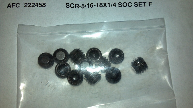

Just ordered a dozen from SS. First call, the salesperson looked up the part and said *502051 was for the drive hub on the headstock. I didn't believe him, he couldn't tell me what size it was, so I took the part* and researched it myself. I cross-referenced it with Dusty's setscrew chart.
SS stock number was for a 3/8 long setscrew. So I ordered 12 of *222458 which is the 1/4 long flat tip setscrews.
I've always said ya can't have too many setscrews! :D

Hey all, I am now well endowed with 1/4 length flat set screws.
[ATTACH]20827[/ATTACH]
I have also just ordered the hardware help kit that Jim recommended. Thanks Jim!
