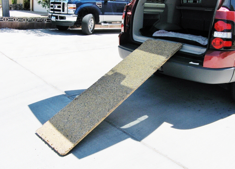

My first Idea was to use a sheet of chipboard covered with a piece of repurposed carpet pad. The chipboard was from a curb find water bed. The frame & headboard were 6 quarter X 11'' cherry or cherry like boards. The board was heavy, hard to handle and would spring up & down when the dog tried to walk up the incline. This didn't work out the dog refused to use it.

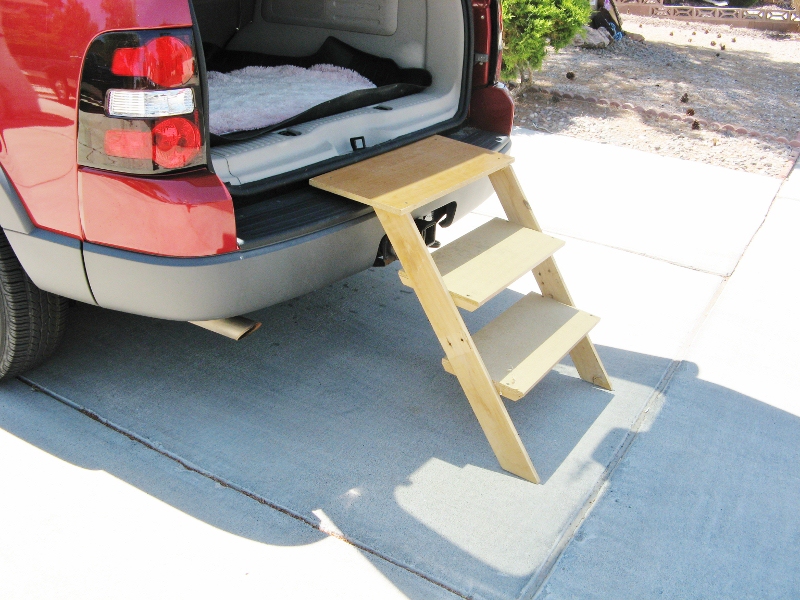

Again my suggestion was to leave the dog. I won't repeat my wifes response. So in the spirit of cooperation the doggy steps were developed. The treads were salvaged from a particle board entertainment center and the stringers were from a pallet.
My suggestion to anyone thinking about salvaging a pallet. Forget it and grab a cold one.
The steps worked well for the dog, she had no problem with them. But they were again heavy and not very portable. they took up a lot of room in the back of the SUV and were not nearly tall enough to work with the pickup.

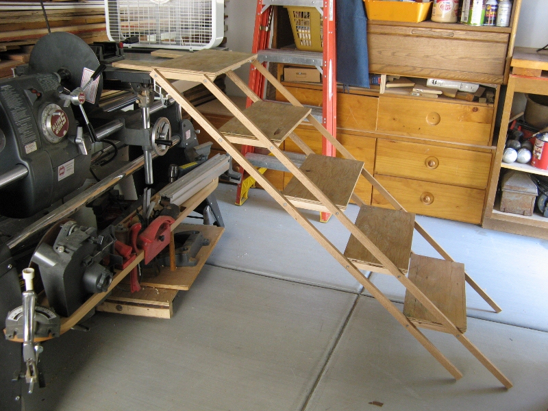

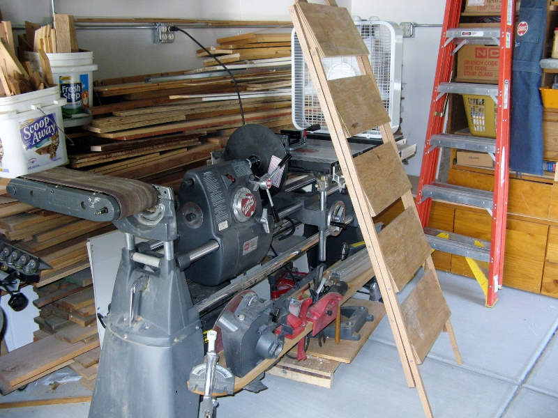

After a impromptu workshop brainstorming session with several friends that included a 12 pack of adult beverage. The doggy folding steps idea was developed (good thing none of us had to drive home).
The stringers were 7/8 in straight grained white oak left over from a previous project. the treads were a little less than 1/2 in plywood from a garage sale. The brace pieces under the treads were cut from hard birdseye maple flooring cutoffs the only purchase was 20 3/16 tapered head bolts and stop nuts.
