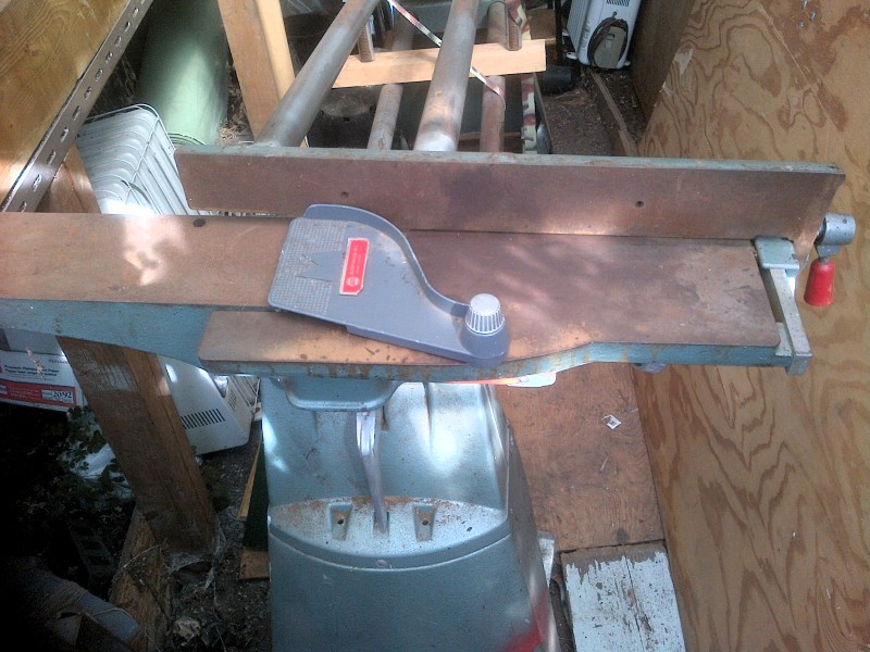

With regard to you joiner table, does it look like this
[ATTACH]22029[/ATTACH]

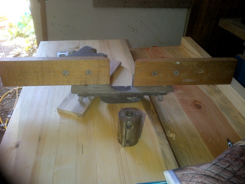

or like this
[ATTACH]22030[/ATTACH]
- 10erjointer2.jpg (96.3 KiB) Viewed 3868 times
- mk5jointer.jpg (130.22 KiB) Viewed 3869 times

I went to vintage machinery.org and downloaded the shopsmith magazine and some other things. The little joiner is like the top picture. It is missing a clip but that should be something I can rig up. Thanks for the welcome. So far every thing is working like a champ. There have been lots of helpfull things on the forum. Wow, 65 years old and still going strong, the machine that is.

It mounts in the table insert slot;)
