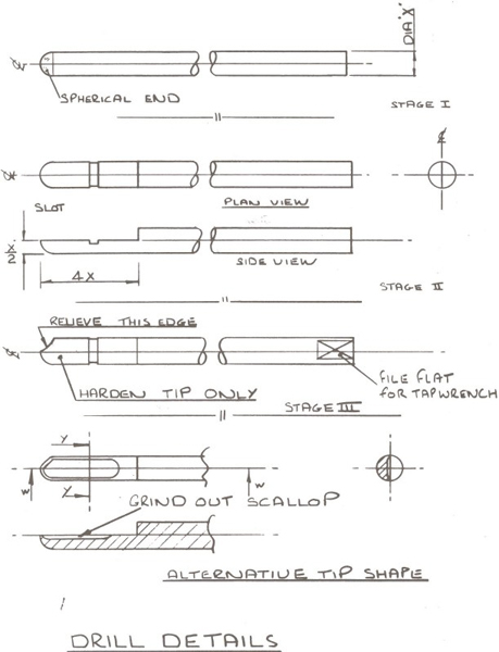

Use a 'D' drill bit. You can easily make one the right size. The initial hole across the diameter becomes a 'catch' when the bit is ground,a nd will engage and help remove the swarf. These drills will not waver a bit. I have used them to drill hole in pipe chanters, and only be out 1/100" at the end of 14" of cocobolo (hard and sometimes wierdly-grained). See drawing.
Using this drill consists of drilling a short starter hole with a regular drill, then introduce this one. Drill a bit at a time, and withdraw the bit to remove the swarf (the wood removed).
[ATTACH]20256[/ATTACH]
