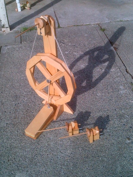

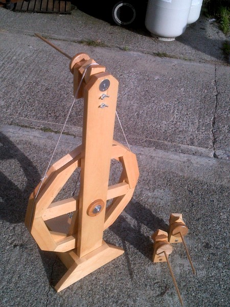

Finished my latest project, a spinning wheel for my daughter, for her birthday. I think I am getting better at this, I was only a week late ;)
[ATTACH]22955[/ATTACH]
[ATTACH]22956[/ATTACH]

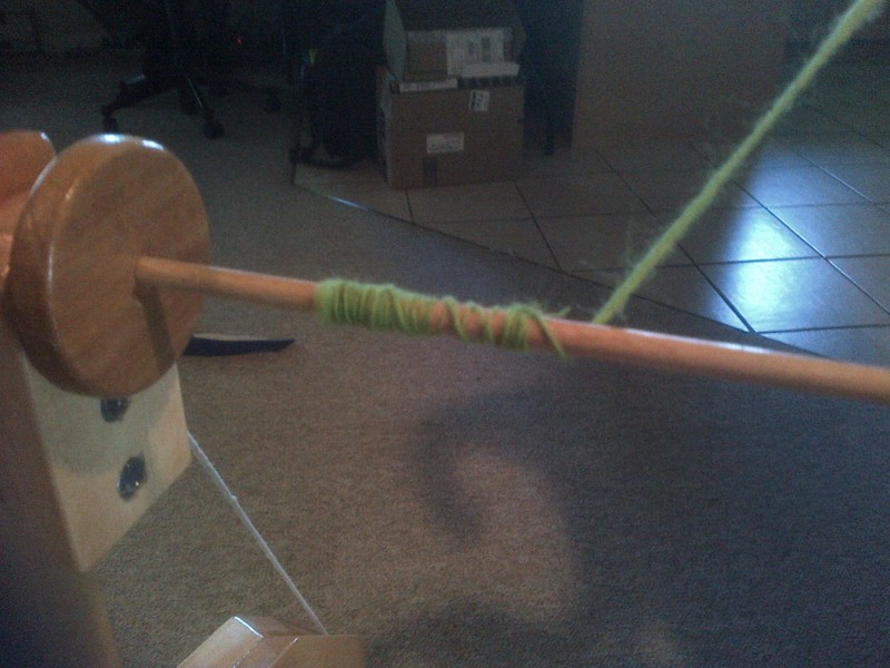

I had to try it out so I borrowed some roving (carded fiber) and spun a few feet of yarn.
[ATTACH]22957[/ATTACH]
Not bad for a first try..
The plans are available for free online. Dodec Spinning Wheel
And the designer has YouTube channel showing parts of the build and how it is used to spin. http://www.youtube.com/channel/UCnOR92miuWYrfKqiEREwKww/feed?activity_view=3
I made a few modifications on the one I built.

berry wrote:Nice job, Im hoping you make a loom next?
Probably not any time soon. My daughter has been sewing all of her own clothes for several years now but only started knitting late last year.
Last spring she took a class on spinning with a drop spindle but wasn't having much success with it. So when I spotted the plans for this wheel I thought I would surprise her with it.
It was not expensive to build, about $8.00 for the wood (2 1x4x8' pine boards) plus 3' of 1/4" hardwood dowel and hardware, maybe $20 total.
I did much of it on my 10ER, the 12 inch disk sander for sanding parts to shape and for cleaning up the end grain cuts, and horizontal boring for the holes in the wheel (first time I have used this mode :)).
My finishing technique needs work. I used a pre-stain wood conditioner (first time for this) :), wipe on stain :) and clear lacquer (lots of drips and runs) :o.
So for me it was a skill building project and quality time in the shop.
