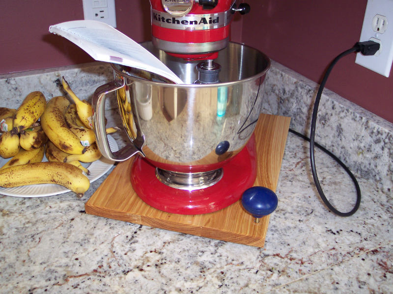

Just a quick project to help the Mother-In-Law with her new bread-mixing machine. It's a nice heavy mixer that she can't manually move, so I made a little cart for it. The cart has some tiny fixed-axle plastic wheels that I got from a trashed TV swivel-stand. It's all made from one plank of hickory wood I had. Also I added a little "brake stand" made from a recycled knob, toilet brass-bolt, and a furniture-fastener. There's a little bit of rubber-coat on the foot of the bolt to made the brake-action less abrasive on the counter-top:
[ATTACH]23254[/ATTACH]
Kitchen Gadget.jpg (112.31 KiB) Viewed 3812 times

Very Cool! I have nearly the exact same problem. What is it you call a "furniture-fastener"? A photo of the underside would be appreciated.

Wow, I thought I could go and find these reused wheels on the Web to refer you to, but no luck so far. Anyway, each wheel is about 3/4" diameter, made of plastic or UHMW. Each wheel has a simple steel rod serving as a (fixed) axle. The underside of the board has 4 wheels installed. Each wheel is given some clearance-room in the underside of the board, that I drilled with a ~ 1" Forstner bit.
I was happy to use that arrangement because I thought the 4 aligned fixed-axles would restrict the cart's movement to one line, and simplify the need for brakes. I actually made the motional axis a little bit diagonal to the axis of the boards, so the "brake stand" at the available corner is closer to the motional axis than it would be with a strictly fore/aft rolling motion arrangement.
Yeah, I thought way too much about all that stuff. In real practice, the MIL pretty much rolls the breadmaker-cart the way she used to drive her cars.... a little on the herky-jerky side.
