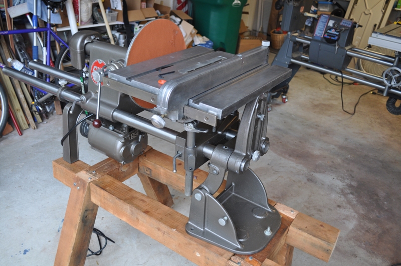

I used Dark Bronze http://www.waresdirect.com/products/Com ... 7Aod12IAag to paint my 3 10ER restorations and liked the looks. Looks almost like Factory color.
[ATTACH]23469[/ATTACH]

fredsheldon wrote:I used Dark Bronze http://www.waresdirect.com/products/Commercial-Products/RustOleum/High-Performance246190?trackURL=froogle&gclid=CPvX_8r9vLsCFaxr7Aod12IAag to paint my 3 10ER restorations and liked the looks. Looks almost like Factory color.
That is gray. 'Factory' color was blue.;)
Whatever, yours looks fantastic!!!:cool:

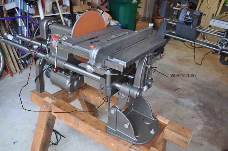

BTW,
[ATTACH]23470[/ATTACH]
I think you already know about the table clamp knob, but what is that other thingey?:confused:
