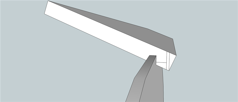

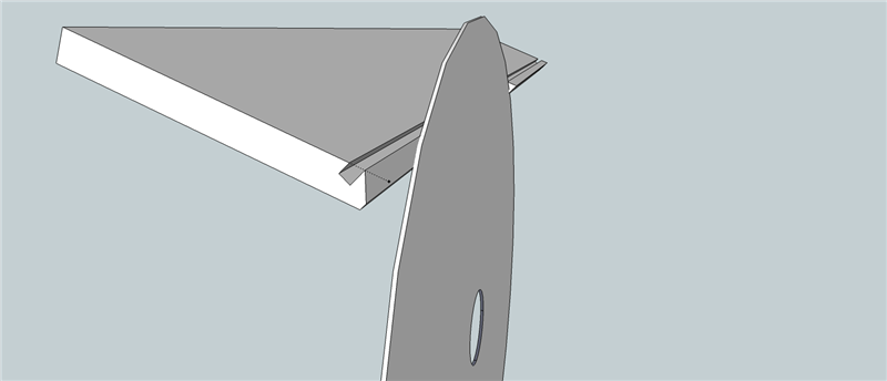

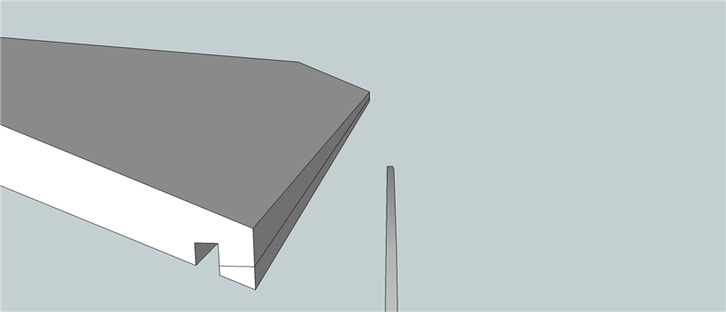

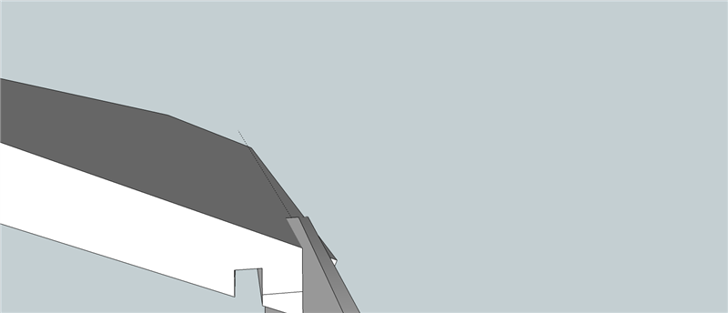

After playing with this in Sketchup, I have concluded that the two sides can be with the table tilted at any angle and that the three or four cuts can all be made without changing the table tilt.
I would start with the side pieces cut as 5/16" thick boards that measure 4"x16".
Then tilt the table right to 22.5° (or any other angle that seems appealing.). Do not change the table tilt until the next three or four cuts are completed.
[ATTACH]23809[/ATTACH]
Cut the dado.
[ATTACH]23810[/ATTACH]
Cut the bottom edge off.
[ATTACH]23811[/ATTACH]
Bottom edge gone. One cut left.
[ATTACH]23813[/ATTACH]
Final trim. Reorient work piece before making this cut.
Cut the dado.
