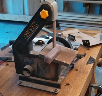

I didn't realize penetrol could be used equally well on aluminum. I may have to do my main table.
I got tired of the black aluminum crap getting on projects from the small tables of my strip sander.
This one is not mine but it is the same model.
[ATTACH]23975[/ATTACH]
I cleaned the tables and put a layer of packing tape on them, very slick no more black aluminum crap on my projects.
strip sander.jpg (84.75 KiB) Viewed 3670 times
