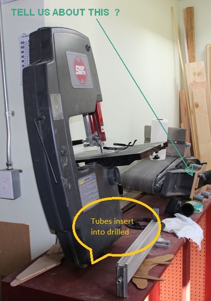

How are you mounting them to the shelf ? That will make a difference in height needed. Are you using the shopsmith accessories mounts ?

[ATTACH]24320[/ATTACH]
This is how I mounted my bandsaw on the shop built "Special Purpose Tool Storage Rack" from Shopsmith plans.
Just drilled some holes in the top and let it lean against the wall. When I getaroundtoit, I'll make the mounting holes more stable.

With the table and rip fence attached, which is normal, the bandsaw is 33 1/2" wide and 35 inches deep. I also have the expansion table that when retracted adds 1/2". Take off the rip fence and it's only 33 inches deep.
Agree with 36 inches tall. Add about 2 inches for the part of the support tubes that don't go into the hole.
