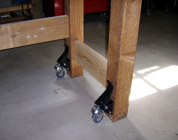

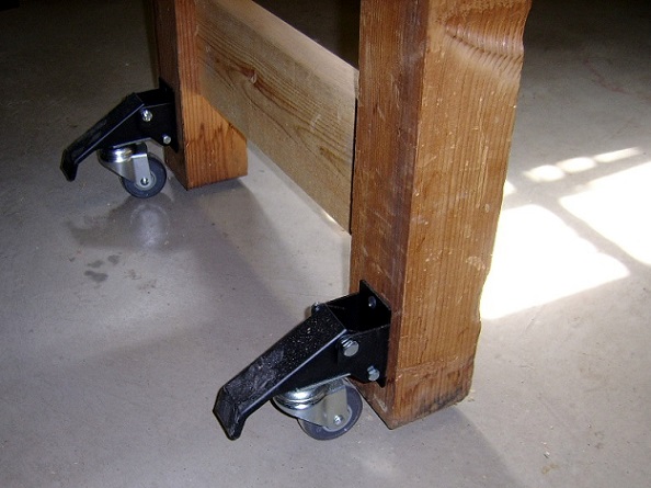

Here’s a couple pictures of the casters I recently installed on my bench. Best thing I did... they’re great. I got them from a local woodworking store for about $60. You can find many reviews on these casters and for the most part they get high marks. The only negative I have is you can only raise/lower one leg at a time. This tends to cause the table to kick over at an angle until a second leg is raise/lowered. Not a real problem... you just need to be aware that it happens.rbursek wrote:All here,
I am going to be making a wood workes bench, I have a few different plans from the net, I plan on using 4x4 doug fir for the legs. Also want to built it a bit shorter then my table saw hight to use it as an out feed table. Any thoughts plans would be appreciated.
Main question here is I am thinking about putting casters on the legs to move it around, but need it stead when working on it and dont want to spend the $ for 4 castors with a brake. Will just 2 with brakes work ito keep it rock solid if I put them on diagnaly opposite legs with 2 castors without brakes on the other 2 legs?
Thanks, Bob
If you are going to try and use your work bench as an outfeed table for your SS saw you’ll need to bring it up pretty high. Unless you are a tall person, the added height could be uncomfortable for some woodworking tasks, like planning, chiseling, cutting dovetails etc. I have two benches, my large one at 35” high and a smaller one at about 41” height. The 41" height I like for tinkering around with stuff... also assembling and disassembling things, but for serious woodworking it’s too high for me. I’m 5’-11”.
[ATTACH]24761[/ATTACH] [ATTACH]24762[/ATTACH]

Paul Green'
It looks like a rectangular opening it the bench top, if so what is the purpose?

rbursek wrote:Paul Green'
Recessed Tool tray. While working at the bench any tool can be laid in the recess thus clearing the top to move the project around and reducing the danger of knocking the tool on to the floor. Keeps commonly used tools handy and located in one place.
Most tool trays are across the back of the bench but benches designed to be worked from on all sides put them in the middle as the one seen in Paul's picture.
