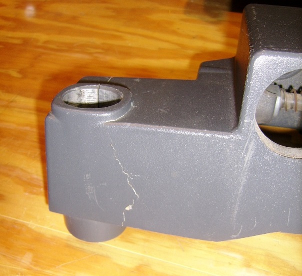

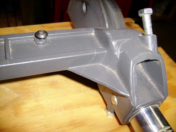

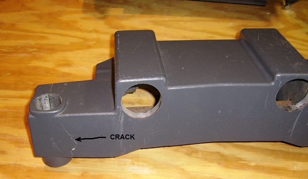

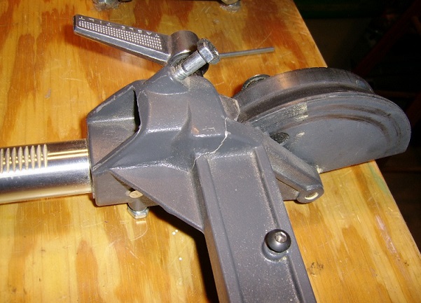

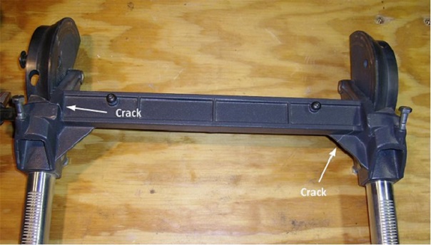

liquid993 wrote:i upgraded my shopsmith in 2004.i have found that i have a crack in the carriage on the left where the table post slides up and down.
can it be welded,has anyone else had this problem?
Yep, I’ve had a cracked carriage. I also thought about having it welded but given the cost and reliability in getting a good weld I instead opted to buy a used carriage. Actually a new one from SS is not too awfully expensive. What you should also do if you haven’t already, is inspect the table assembly. Particularly the structure under the table… the table bar and tube. This is a casting structure that the trunnions attach to and also the two vertical tubes that raises and lowers the table. If your crack was similar to mine -- near the tube hole, I suspect it may have been caused by a force transmitted from the table tubes. Perhaps the table was hit by something or it hit something, or maybe overturned at some point. This likely applied a high bending force in the tubes that caused the carriage structure to crack. Anyway, it wouldn’t be a surprise to see cracks in the table bar and tube cast structure also. I found cracks in mine. Here are some pictures.
[ATTACH]24804[/ATTACH] [ATTACH]24805[/ATTACH]
[ATTACH]24806[/ATTACH]
