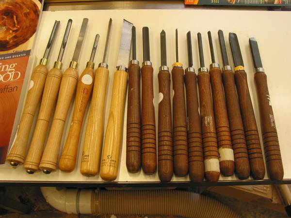

At present, my lathe tools are limited to the basic 5-piece Shopsmith set. This set just popped up nearby on Craigslist. Sixteen tools and four books for $80.
[ATTACH]25073[/ATTACH]
There's quite a bit more info in the Craigslist ad.
So, experienced wood turners:
1. Do I need these?
2. Are they reasonably good tools?
3. Is this a good deal?

Not a bad set especially if all are HSS.
The craftsman that look like Sorby probably are. As you most of us know Sears does NOT make their own tools. They are made by other companies under contract.
Nothing wrong with Buck Bros either.
The opportunity for experimenting with your own custom grinds is worth it. I have several copies that now have different grinds.
Especially skews which I have put a radius grind ala Alan Lacer. I really like the radius grind on the skews. but it's good to have some straight ones too.
Bowl gouges are very good to have and need not be limited to bowls.
Low ball at 50 and start from there.
Good score on the RM for $20
Terry

Thanks, Terry. I checked out Sorby tools, and your private-label theory makes sense. If accurate, the asking price is a good deal for those alone.
These fall into the category of nice-to-have, but no immediate need. Which is when I can wait for a great deal. So I'll give it a few days, and then make the $50 offer. Will let you know what happens.

Last fall I was in a class led by Alan Lacer. A couple folks brought in their chisels. The consensus was that Sears sets that looked like the dark handled ones could be challenging to sharpen using the typical turner style of grinder due to the short blade length, but were otherwise okay enough tools. Maybe they would sharpen easier on the SS using the lathe chisel grinding jig.
If the 3 light handled chisels are indeed Sorbys, then even the asking price would be a bargain. A 1/2" Sorby bowl gouge runs $90 at Woodcraft.
Looks like Buck makes some lower end tools, may not be HSS, so be careful about assuming they have much value or that you'd even want to use them much.
Good luck,
Roy
