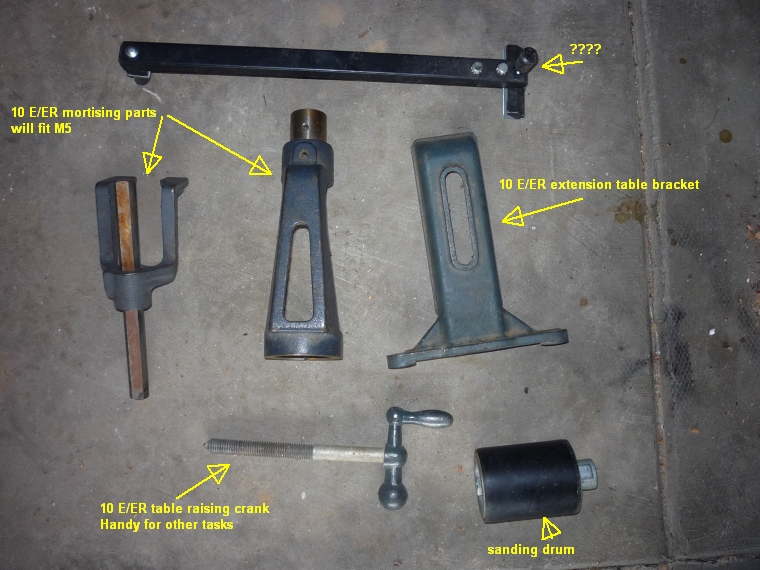

Black thing looks like a table saw fence of some type.
beatnik wrote:Black thing looks like a table saw fence of some type.
Wonder what it fits?
beatnik
Posts: 194
Joined: Sun Jun 15, 2014 3:40 pm
Location: DFW
Post by beatnik »
JPG40504 wrote:Wonder what it fits?
Looks to be from one of those Kmart, Handy Dan models. ;)
