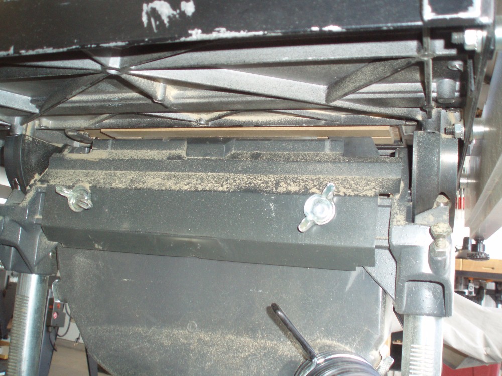

Does the attached photo show a lower saw guard (though terribly dirty) that is similar to yours? If so, your problem is as reible already stated. You simply need to adjust the lower saw guard width. If I understand your problem, the interference occurs just below and to to either side of the wing nuts (which you won't have).
I typically operate with the lower saw guard adjusted to less than half of its' possible width. There are varied opinions on what this does to (for) dust collection efficiency but if I turn my DC on, it works very well.
[ATTACH]25978[/ATTACH]
What you see here is what happens when you cut wood with the dust collector connected but turned off. I seem to do that a lot.
This is a very loosely connected thread regarding a modification to the lower saw guard that is intended to improve dust collector efficiency. I think it works very well, if the DC is turned on.
