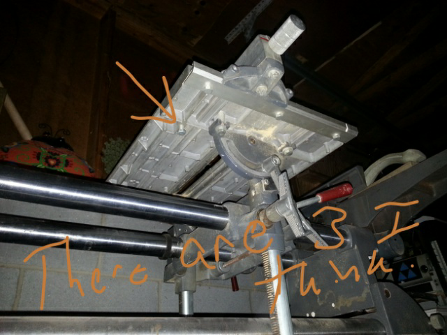

I have some bolts threaded into the bottom of my table saw table. They are not holding anything. Any clue what they might be for? I'd show pics but I am having trouble uploading for some reason.

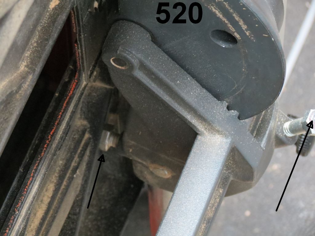

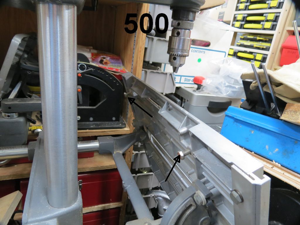

Here are a couple of pictures showing some bolts for you to look at. If these are the ones then they are for adjustment in drill press mode so the table is stopped at 90 degrees, (there are also stops at 45 degrees) this is just for your information.
[ATTACH]26146[/ATTACH]
[ATTACH]26147[/ATTACH]

Here is a pic. Thanks for the help.

Well...I thought the pic showed up. Thanks for posting that pic. I was hoping to use those bolts to attach an outfeed table.

Those are the stops for the table tilt.
