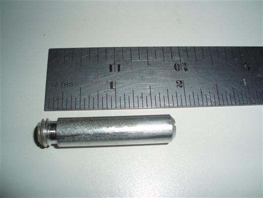

[quote="JPG40504"]I am currently one state south of 'normal', but IIRC they be 3/8" and are 3/8-16 thread. Also IIRC they differ from a 'normal' screw thread in that the 'end of thread' is undercut creating a shoulder that provides a positive 'stop' when tightened in the insert. If that second 'IIRC' is incorrect, that is the way they 'should' be!]
[ATTACH]18930[/ATTACH] is photo evidence that JPG is right on.
Shaper Pin 001 (Custom).JPG (28.4 KiB) Viewed 2847 times

dusty wrote:is photo evidence that JPG is right on.
Never doubted it....
But a picture is worth a lot of words
Bruce

Are there part numbers to get replacement screw-in starter pins for the sander/shaper insert? Thanks.
delong94 wrote:Are there part numbers to get replacement screw-in starter pins for the sander/shaper insert? Thanks.
Either call CS or make a couple from screws(remember to under cut the threads).
