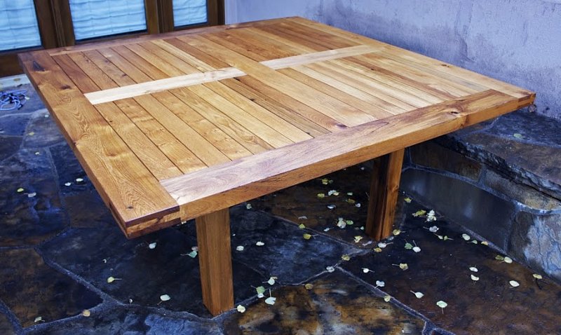

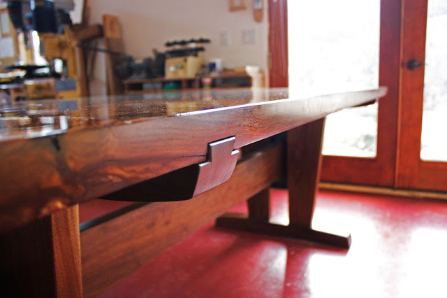

A garden-variety tabletop is going to need some some support in order to avoid sagging or warping. Especially a solid-wood top in the cross-grain direction. An apron is an efficient way to provide that structure.
But it's certainly not the only way. Check out this design:
Or this one:

BuckeyeDennis wrote:A garden-variety tabletop is going to need some some support in order to avoid sagging or warping. Especially a solid-wood top in the cross-grain direction. An apron is an efficient way to provide that structure.
Or this one:
Wow, I love the sliding dovetail! :eek:
This one, he is using a "frame" around the panels with a "floating" panel idea in the frame like a door or cabinet door? I assume the frame then becomes the apron.
Thanks Dennis, I appreciate the clarification!
