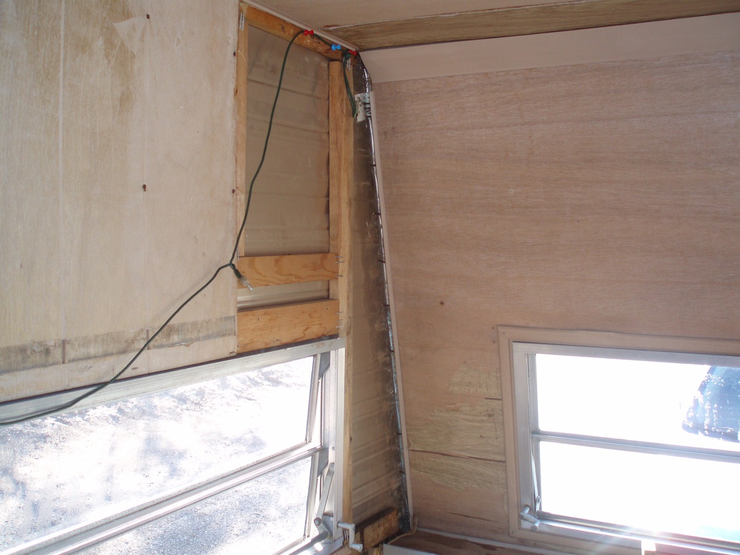

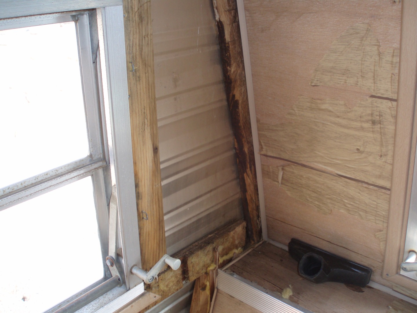

My thanks to all of you for all the feedback. It [s]will be[/s] has been helpful, however, my priorities have just taken a big turn.
We had some unusual rain the last few days and some indications of water leaks become apparent when they had not been before. One thing led to another and the next thing I find myself doing is pulling down interior panels (at least parts of them).
I have structural problems that will need to be fixed before I concern myself with hanging doors.
A couple pictures tell it all.

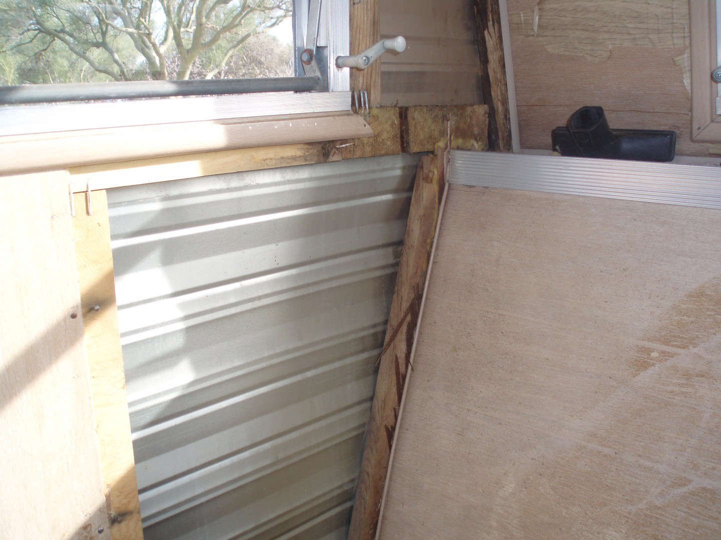

Re: Recovering from Water Damage in RV
The source of the leak has been identified and temporarily repaired. The damaged wood on the interior has now been removed and I am trying to figure out how to facilitate the repair (without doing a kludge job). Numerous screws and stables make it difficult to install the replacement parts.
