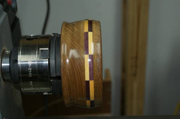

bowl with ring one.jpg (70.29 KiB) Viewed 4804 times
