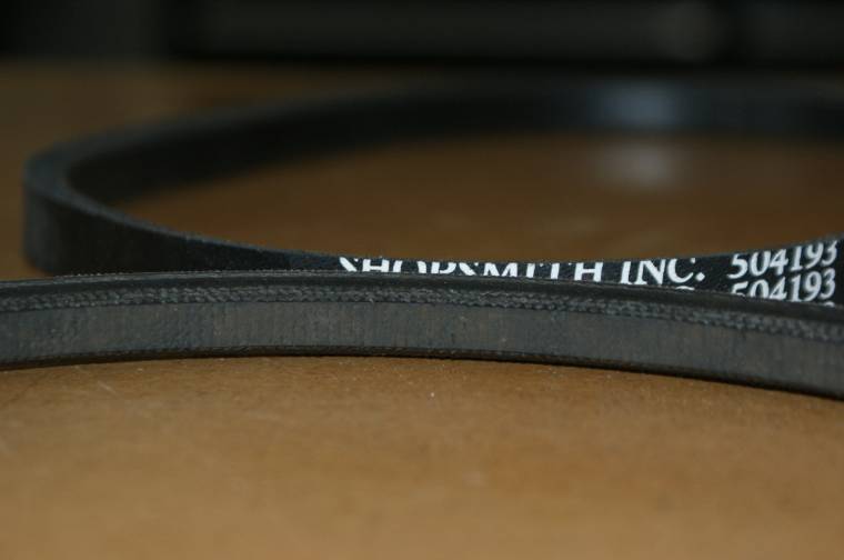

Are you sure that the motor actually stopped turning? If the motor shaft binds enough to stall the motor them the fuse for the circuit powering the SS will blow. If the fuse did not blow then the motor probably did not stall. I believe that the apparent stalling may be caused by the V belt becoming slack when the control sheave ( the one controlled by the speed control) opened and the one on the motor did not close to keep the V belt in proper tension. This condition is generally caused by dirt and debris in the sheave shafts causing restricted movement. The only good remedy ( IMHO ) is to tear down the headstock and do a thorough cleaning and oiling. :( Also check the V belt for proper size. The widest edge of the belt should be about 9/16 inches wide.
You can try to start by only oiling the machine but I have found that in a lot of cases oiling alone does not clean out the old oil and crud inside the sheave bores.
The photo shows the difference between the size of a new belt compared to an old belt.
old and new belts.jpg (74.82 KiB) Viewed 1868 times
