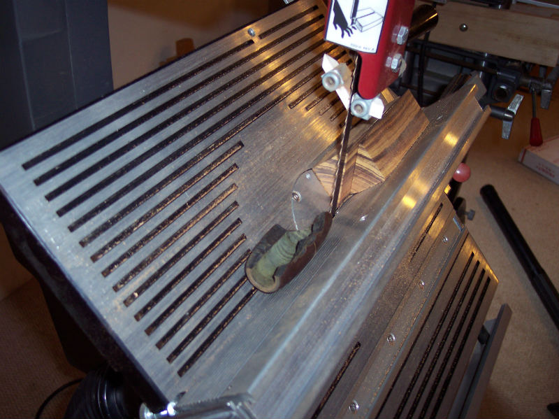

First I selected an Ironwood blank and resawed it like so.... Subsequently I jointed the pieces flat on a sheet of sandpaper, and tacked the extreme ends together with JB-Quik epoxy:
[ATTACH]24192[/ATTACH]

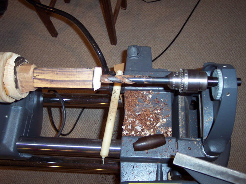

It was next glued onto the previous scraps attached to my lathe faceplate. I found the middle and started a 5/8" bore with a brad-point to take advantage of the center spur. Then I switched to a metal-bit and kept rubbing it with beeswax as I sank about 4-1/2" of bore depth:
[ATTACH]24191[/ATTACH]

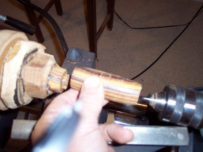

I shaped the hot-dog and separated it; one end of it still had a tiny bit of glue tacking the 2 halves together:
[ATTACH]24193[/ATTACH]

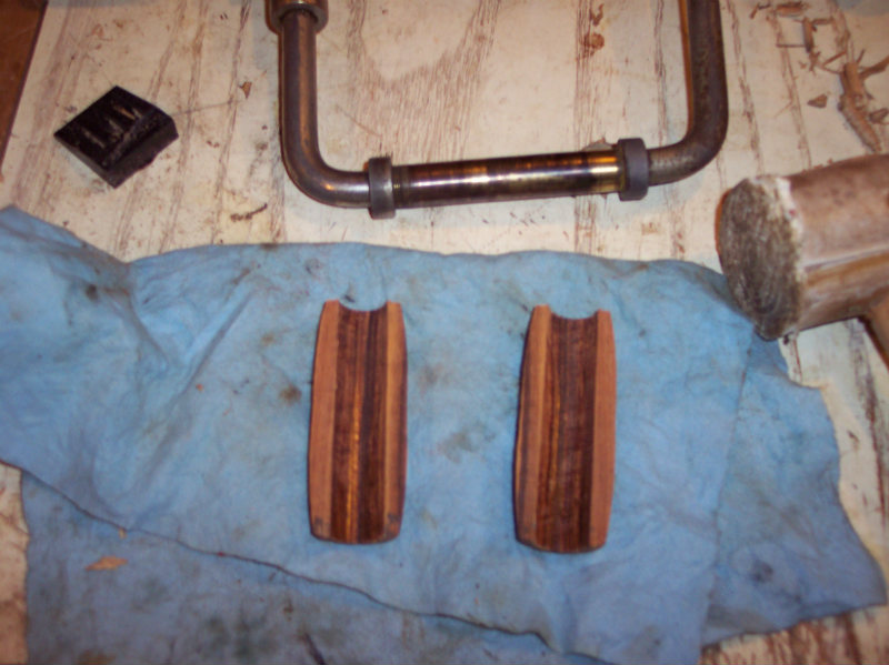

Then I split it open by tapping it against my live-center cone. I was left with 2 perfectly symmetrical halves:
[ATTACH]24194[/ATTACH]

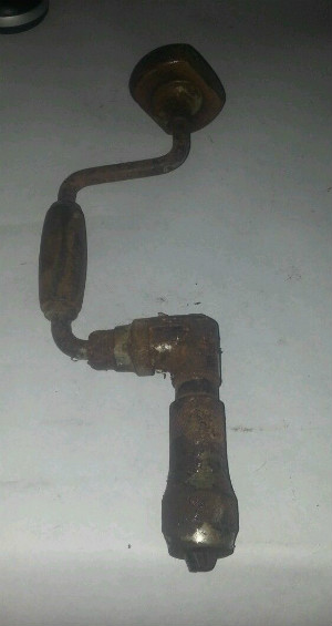

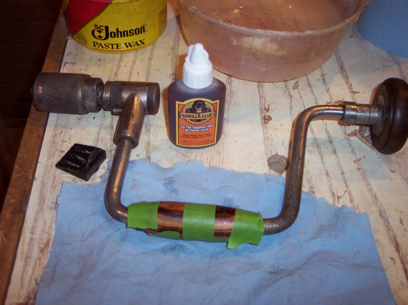

Now at last I can assemble it to the target, a very rough-looking but extremely finely-made Yankee / North Bros. / 2101 ratcheting brace. These are like the "Cadillac V16" of braces, and they're usually expensive to this day when in good condition. Of course I deliberately bought one with a busted handle to save money. My rebuild is almost complete:
[ATTACH]24195[/ATTACH]

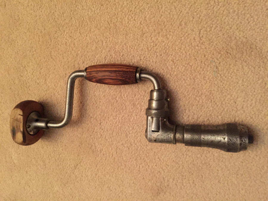

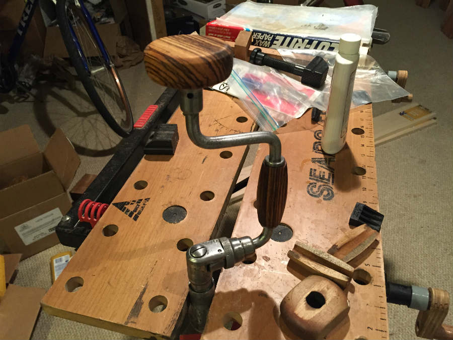

I like having a couple of braces around but I like them to be 'special.' The big Yankee is still in the shop from last year. Then I found out that 6-inch sweep braces are very very rare, so I jumped on one that looked terrible but was cheap:
I used the similar resawn/tacked/turned/separated/reglued technique for changing one grip to Zebrawood:
Then I finally got around to the top Bun, also from Zebrawood. Lots of elbow-grease in this petite thing!
