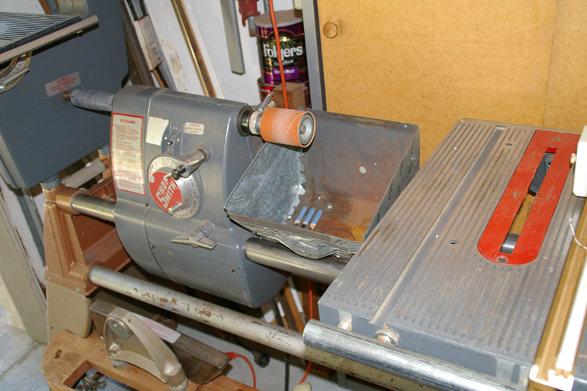

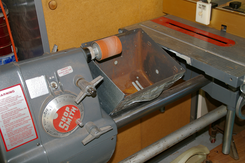

Your post caught my eye and what I made for a drum sander dust collector might work for your pen turning accessory. I don't turn pens, but if I did I see no reason why it wouldn't work. The beauty of this thing is it is heavy enough that it doesn't move and fits between the tubes just right. The air circulation slots could be removed so bigger chips would pass. I see these on eBay quite often for almost nothing.
Don G
P.S It's a Mark VII motor pan in case you hadn't noticed.
Don G
