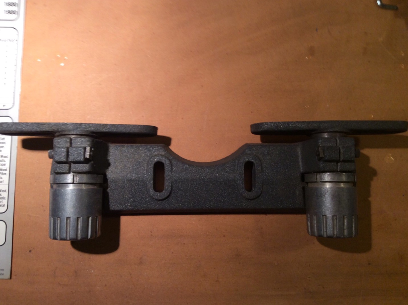

Can someone tell me what is the part I attached a picture of? I can't figure it out... I just both a used mark v off Craigslist.
- image.jpeg (220.99 KiB) Viewed 5901 times

Welcome aboard.
That piece is part of the shaper fence. Shaper Fence

It is missing the two wooden fence faces.
Also it ain't a Mark 5/V part! It fits a Mark VII.
See the last pix for all three versions. http://www.shopsmith.com/ss_forum/viewtopic.php?t=13031

I thought it looked like a shaper fence without the wood, but the mounting holes threw me, so I kept my fingers and keys to myself, because I knew some one else could/give a definitive answer.
