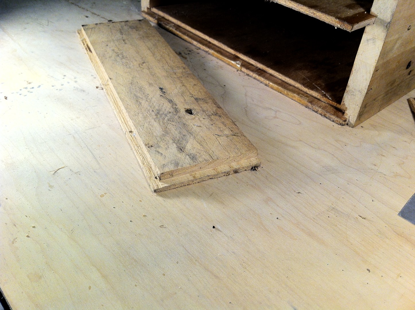

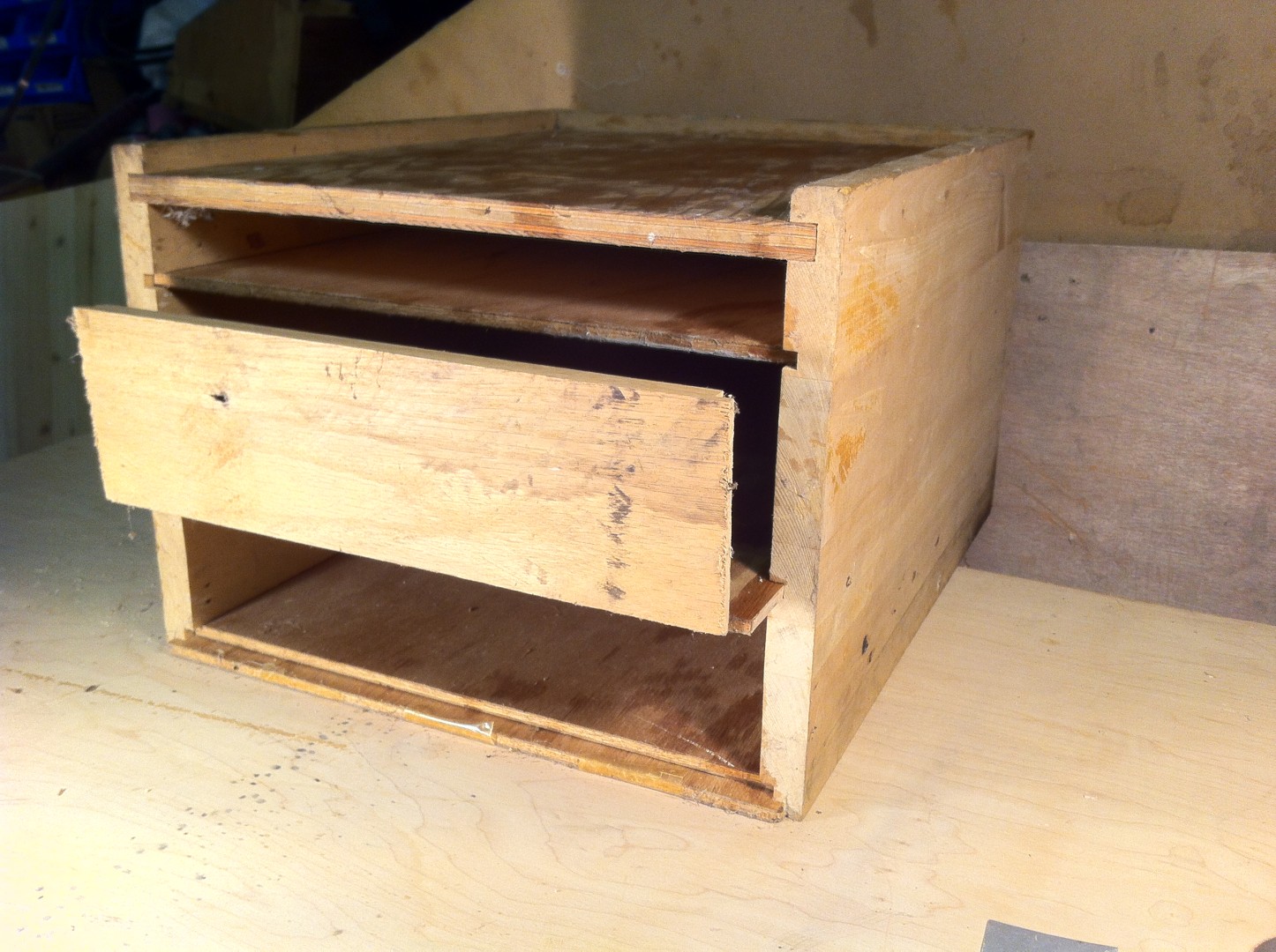

In the revised plans he specifies using "hardwood runners", It is not very clear, but I think the runners would fasten to the sides of the drawers and slide in the dadoes, (dadoes would need to be repositioned)
An alternate way to do the drawers it to make the bottoms wider than the drawers and size the dadoes so that the edges slide in the dadoes.
To illustrate this is a box with drawers that I started back in the Seventies and never finished, I did finish it's twin but that one has gone missing over the years.
The drawer sides and back are missing but you can see how the front goes on, the back and sides would be attached on top side of the bottom.
