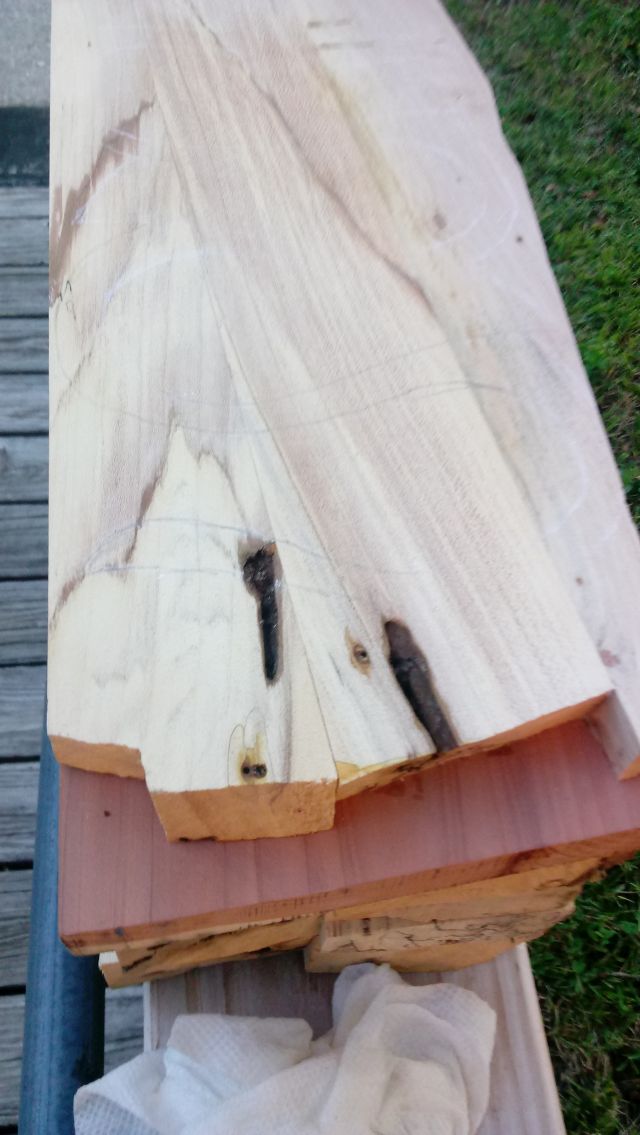

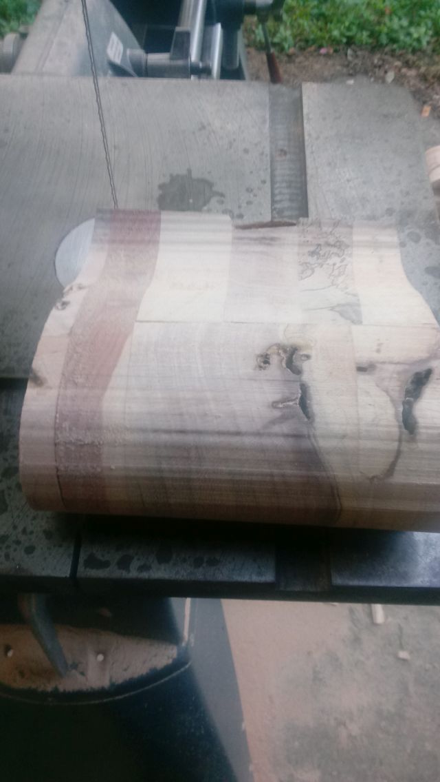

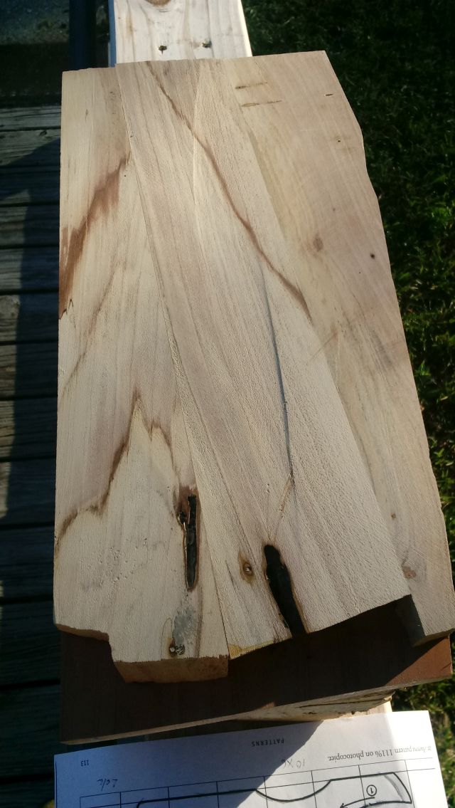

Some one wanted to know how dogwood looked and worked. From this only experience it is a hardwood, but the sap wood is very porous. You could actually pour polyurethane straight onto the wood and for the first few minutes it would simply absorb out of sight. Since this tree was not large enough, I had to add some wood that I had on hand from other trees. One board is cedar which will help with keeping the bugs away from the felt lined drawers. The other small piece is a piece of pecan that before glue up I thought would have fitted in the wood. Well, you can decide. Just for newbies, this is going to be procedural. So here is what I started with. First 2 pictures are the lamination results.
Last picture is pattern transfer. This pattern is from the book of Lois Keener Ventura. The patterns are in the back which you can take to the print shop and and enlarge until the squares in the pattern are nearly one inch square. Then use those copies to put chalk on the back along the lines. Put the pattern over the wood and draw on the same lines transfering the chalk to the wood. Remove the pattern and trace again the chalk line pattern with a pencil or pen, whatever you can see. More to come.

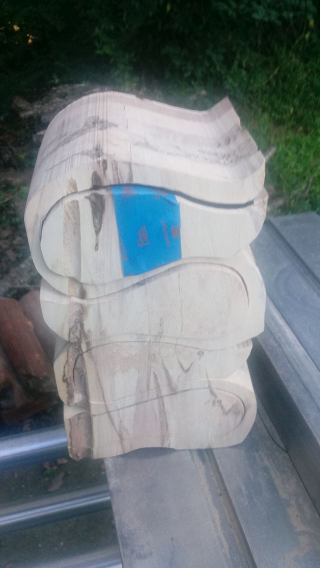

First picture is retracing the pattern with a pencil and it can be faintly seen.

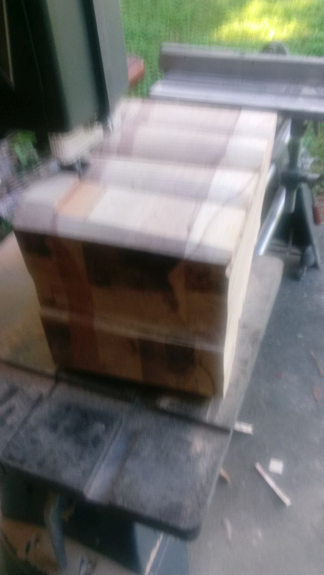

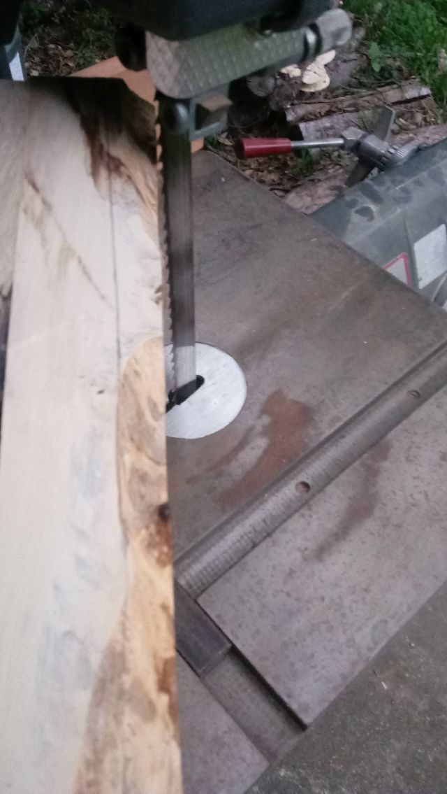

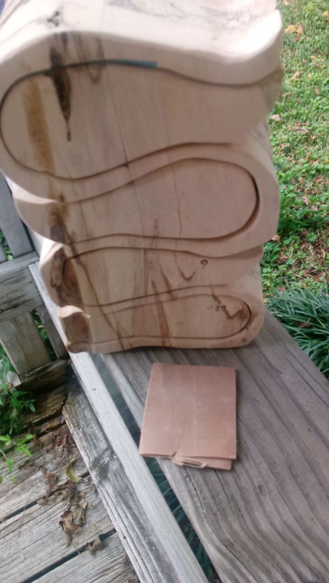

Second picture is a mistake. I was about to cut off the back but I had not cut out the outside of the pattern yet. But I did trim to square up the wood. It measures 6" X 6" X 12" long. Then it had to be sanded so that the face and back surfaces were relatively smooth. Perfectly square is not required, only relatively.

- Changed out bandsaws from 1/2" blace to 1/8". About to get serious.

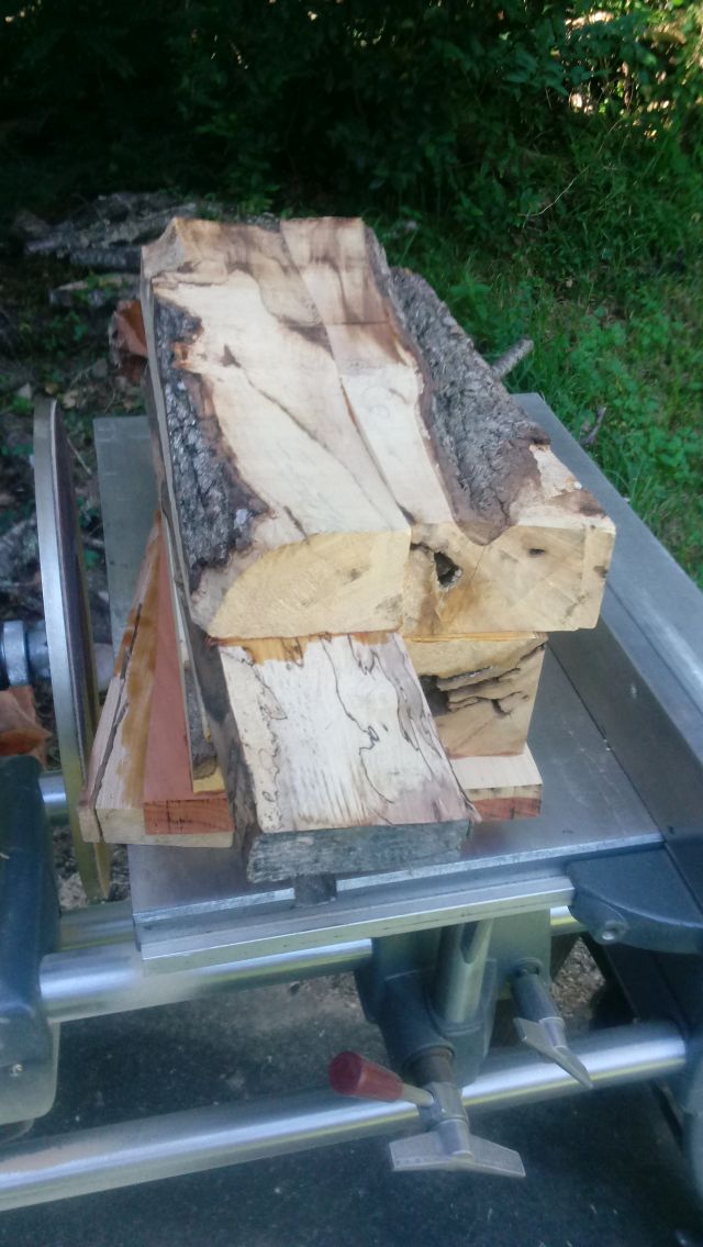

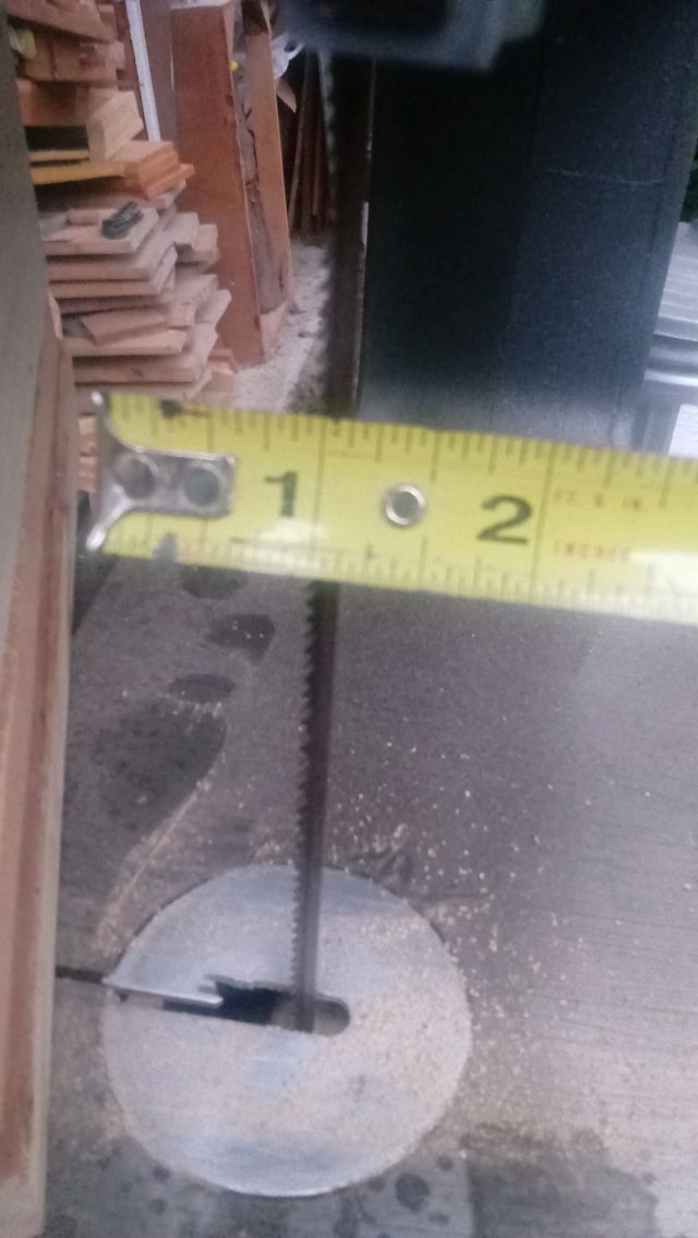

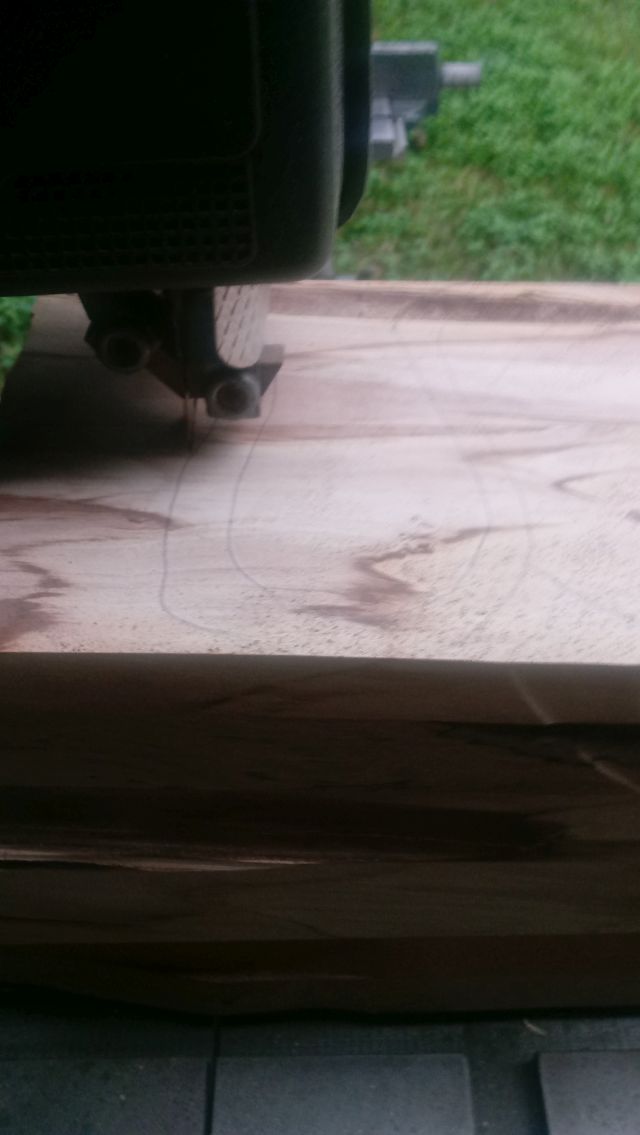

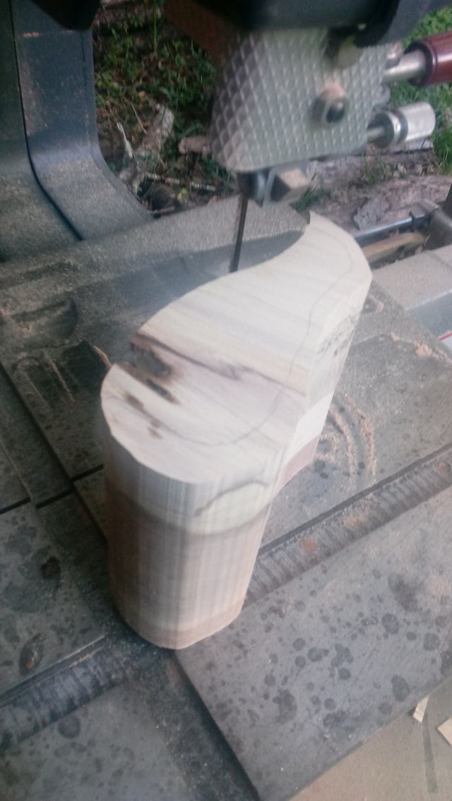

First picture is cutting off excess at top of box and making the general shape. It's a real squeeze.

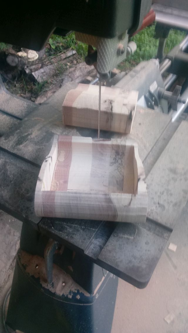

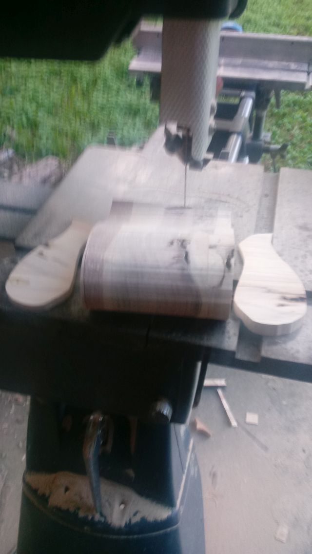

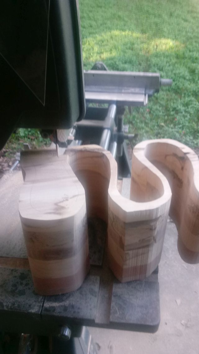

Second picture is side view of cut out shape. Sorry for the shakiness of my hands. This caused many problems not being able to control the cuts.

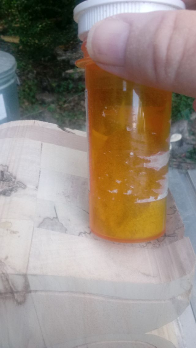

Third picture is collected sawdust to help fill in some cracks to minimize the visual appearance of glue holidays. A mixture of the sawdust with the glue makes it harder to see, especially if you sand it smoothly.

- almost minimal clearance

- shaky hands make blurry pictures
- ss box i.jpg (63.27 KiB) Viewed 31985 times

And now we turn to making the drawers.
Just a comment from experience, the straighter you cut the front and back off the drawer chunks, the easier it will be to line them with felt. If you do flocking, it is insignificant.

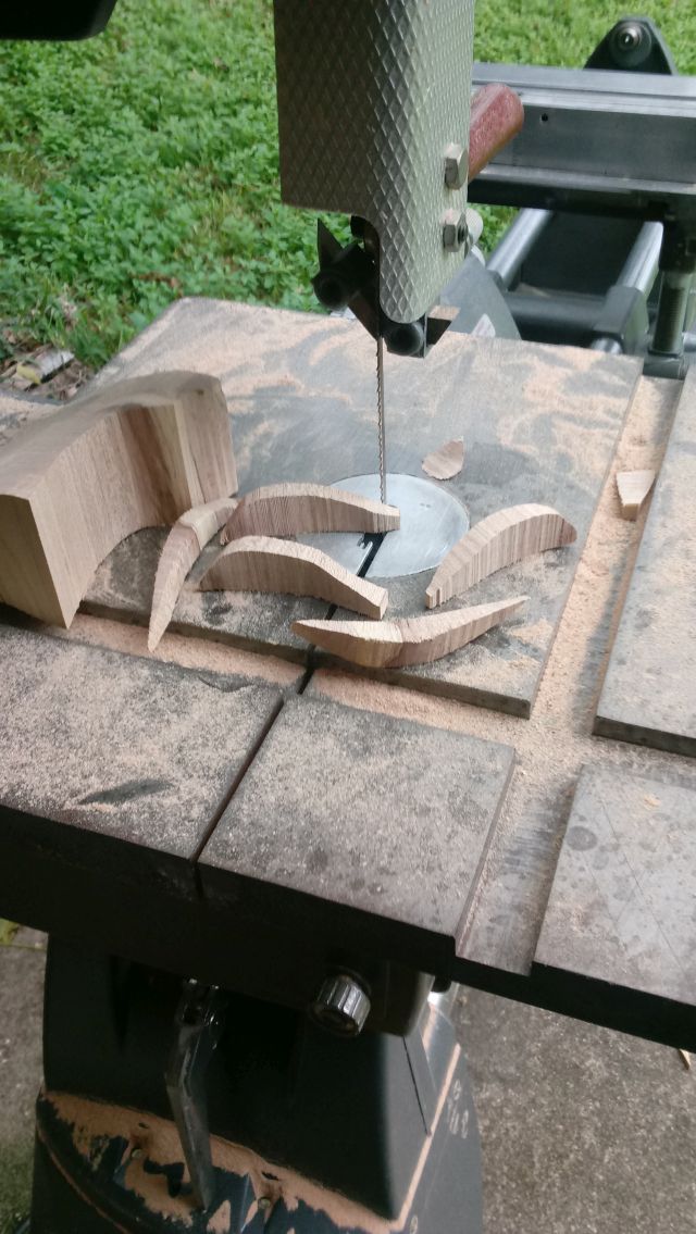

To hold the pieces together and ensure that the small pieces remain in the correct drawer, I like to use tape to keep them together. That way when I start gluing, they will all match up correctly and look and work right.

- demo of how they will look glued back together.
- ss box o.jpg (86.23 KiB) Viewed 31982 times

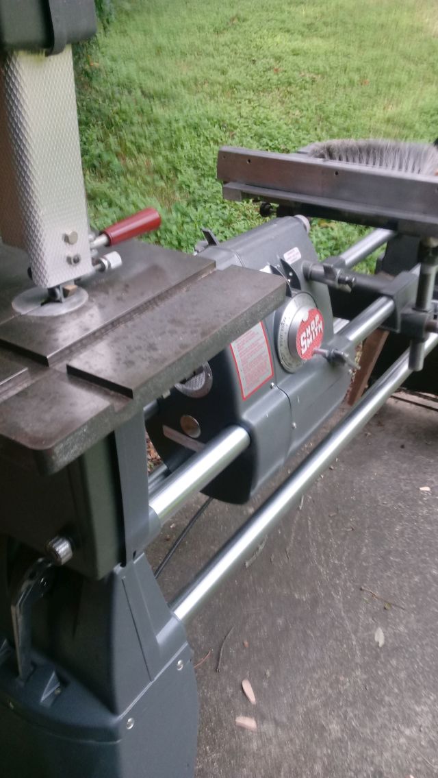

Second picture is after cutting all the pulls out of the inner block of wood from one of the drawers. Last picture is that the old Shopsmith has been cleaned up to put away until the next project.

- Shopsmith cleaned up for next project
- dogwood SS C.jpg (117.38 KiB) Viewed 31881 times
