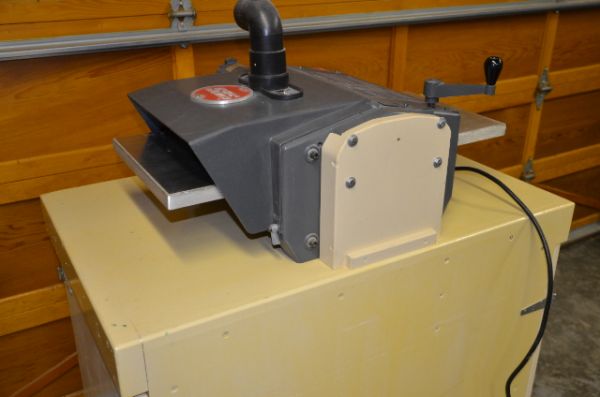

My SS mount planer came on a cart made by the previous owner. It is kind of jammed in right now, so I can't get to the other end to see the motor or pulleys.
planer side.jpg (26.31 KiB) Viewed 5564 times
Re: Powered SS Planer Cart
The differences AIUI are:
1) cast iron vs clad aluminum table(lighter for the SS mount).
2) feed motor speed range(minimally relevant IMO)
3) color(totally irrelevant)
I do not know of any thing that would limit the motor choice(1.75 on my to do list)
That is an interesting belt cover!
