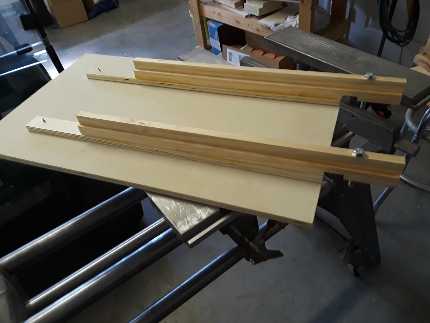

Does anyone have a picture of how the out feed table or support table mounts on a model 500? I see how it does on the other model that have table extensions.

dannyshamoon wrote:Does anyone have a picture of how the out feed table or support table mounts on a model 500? I see how it does on the other model that have table extensions.
Thanks
Danny
There was a post recently on the Facebook, Shopsmith Owners Group that showed how one member did his.
https://www.facebook.com/photo.php?fbid ... oQbuhWm7fe
500 outfeed table top.jpg (236.96 KiB) Viewed 5308 times
500 outfeed table bottom.jpg (218.95 KiB) Viewed 5308 times

Ron.... THANKS, do you have a picture of it mounted on the back side? How does it attach to the table?
Danny

dannyshamoon wrote:Ron.... THANKS, do you have a picture of it mounted on the back side? How does it attach to the table?
Danny
I believe there were only the two pictures in the post, he does give more details in the comments.
Not positive, but it looks like the bolts in the rails (right side of the second photo) go into threaded holes in the back of the table (one can be seen protruding at the back of the left mitre slot in the first picture)
