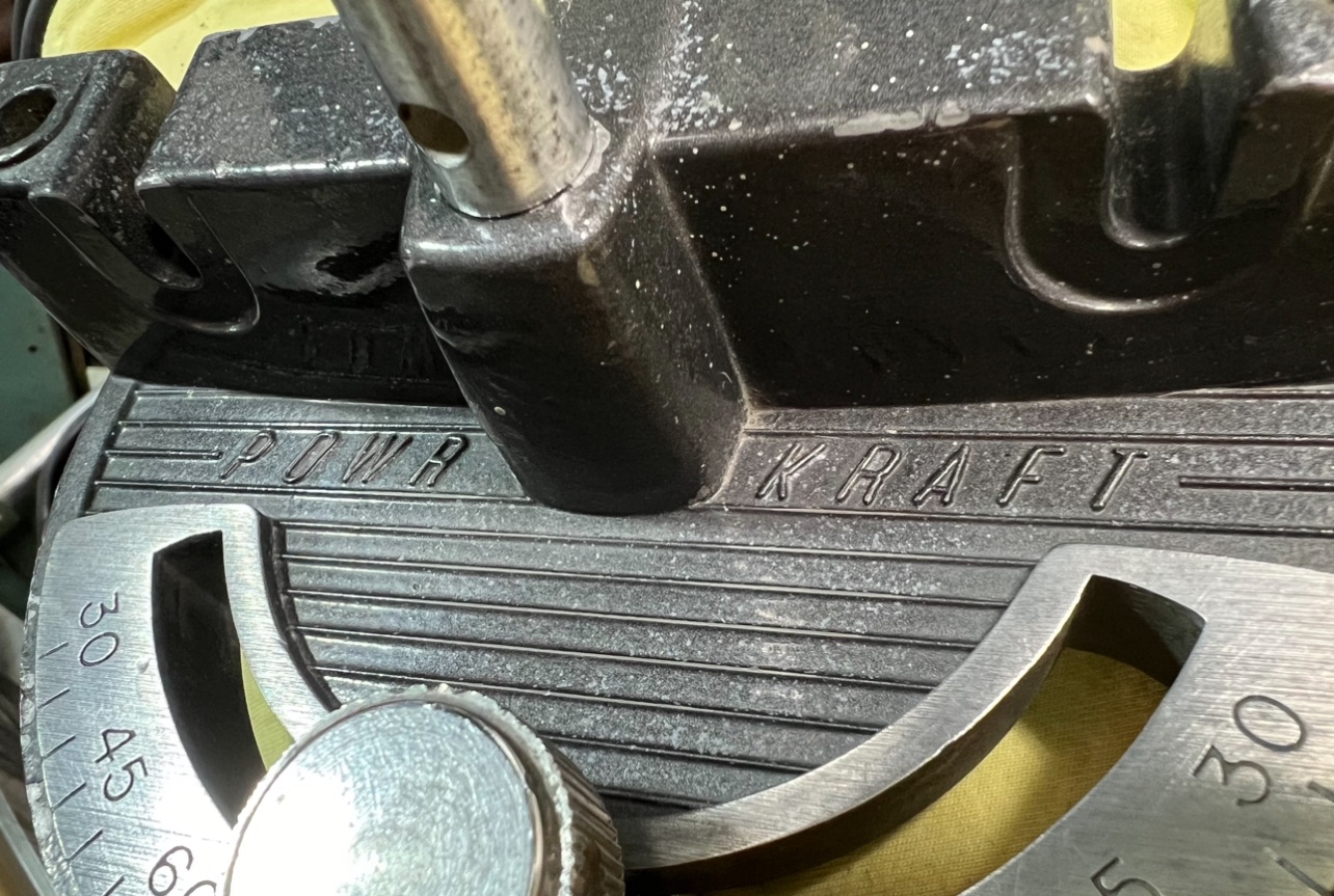

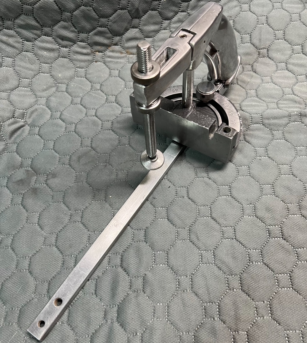

cmulder wrote: Fri Jun 04, 2021 3:43 am So I THOUGHT the Miter slot on the saw on the Magna 9 Inch Bench Saw which I believe is a model 710 from the 1950s was 3/4 inches. However, I purchased one on Amazon and it's just hair too big. Is there an aftermarket one that fits?
I realize this is a very old thread, but did you ever find a miter to fit your 710? I recently acquired a 710, including a miter, and have come to learn that it is not compatible with a Mark 5 table.
There is another source for these that seem to come up on eBay more frequently. These are miters that Magna made to fit Powr-Kraft branded table saws that they also made. They look like a Mark 5 miter, but have no slot in the bar.
