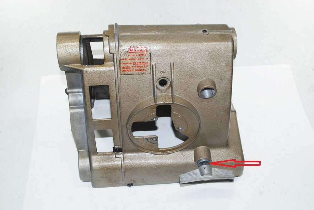

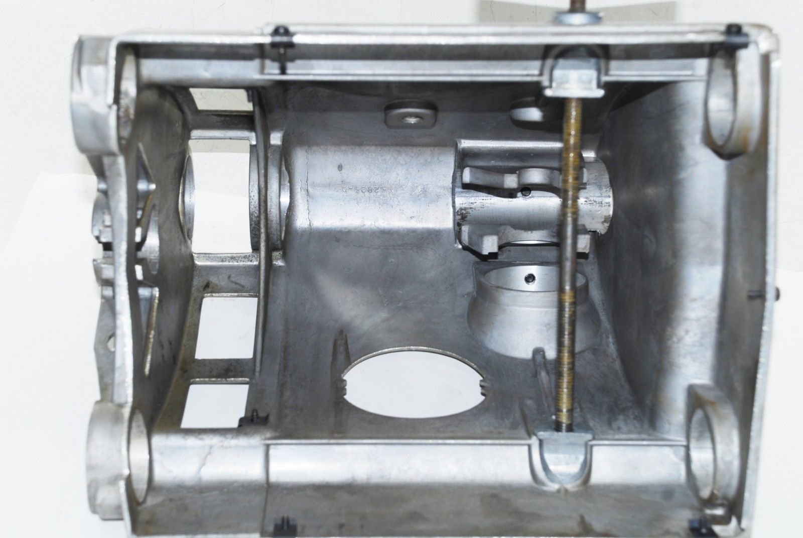

In the first picture below the Lock Wedges are almost against the Headstock Casting. Having the Wedges pressing but not overly tight, against the Headstock Casting on both sides does two things. First it makes it easier to remount the Headstock on the Way Tubes having the Wedges stay in place in the proper position. Second this is an easy way to adjust the Wedges on the threaded Lock Rod. Getting them adjusted correctly may require turning either or both Wedges individually so they rest against the Headstock Casting on both sides while leaving a couple threads showing between the Lock Lever and outside edge of the Wedge as shown in the second picture. Do that adjustment first leaving a couple threads showing between the Lock Lever and the front Wedge. Follow by adjusting the rear Wedge against the Headstock Casting. With this done turning the Lock Lever will draw both Wedges to the center of the Headstock and against the Way Tubes when the Headstock is mounted on the Way Tubes.
If either Wedge needs to be replaced keep in mind that one is right-hand threaded and the other is left-hand threaded.
