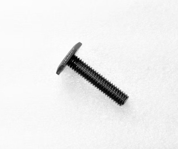

You had a nice description of what you did but as they say a picture is worth a thousand words. Maybe you can post a picture or two of what you did.
The Jointer Hex Head Screw SKU 506720 is currently listed as out of stock. I don't believe that will continue for long since it is needed in making new Jointers. This is the Jointer Hex Head Screw used on Jointers since late 1955. That one is pictured below.

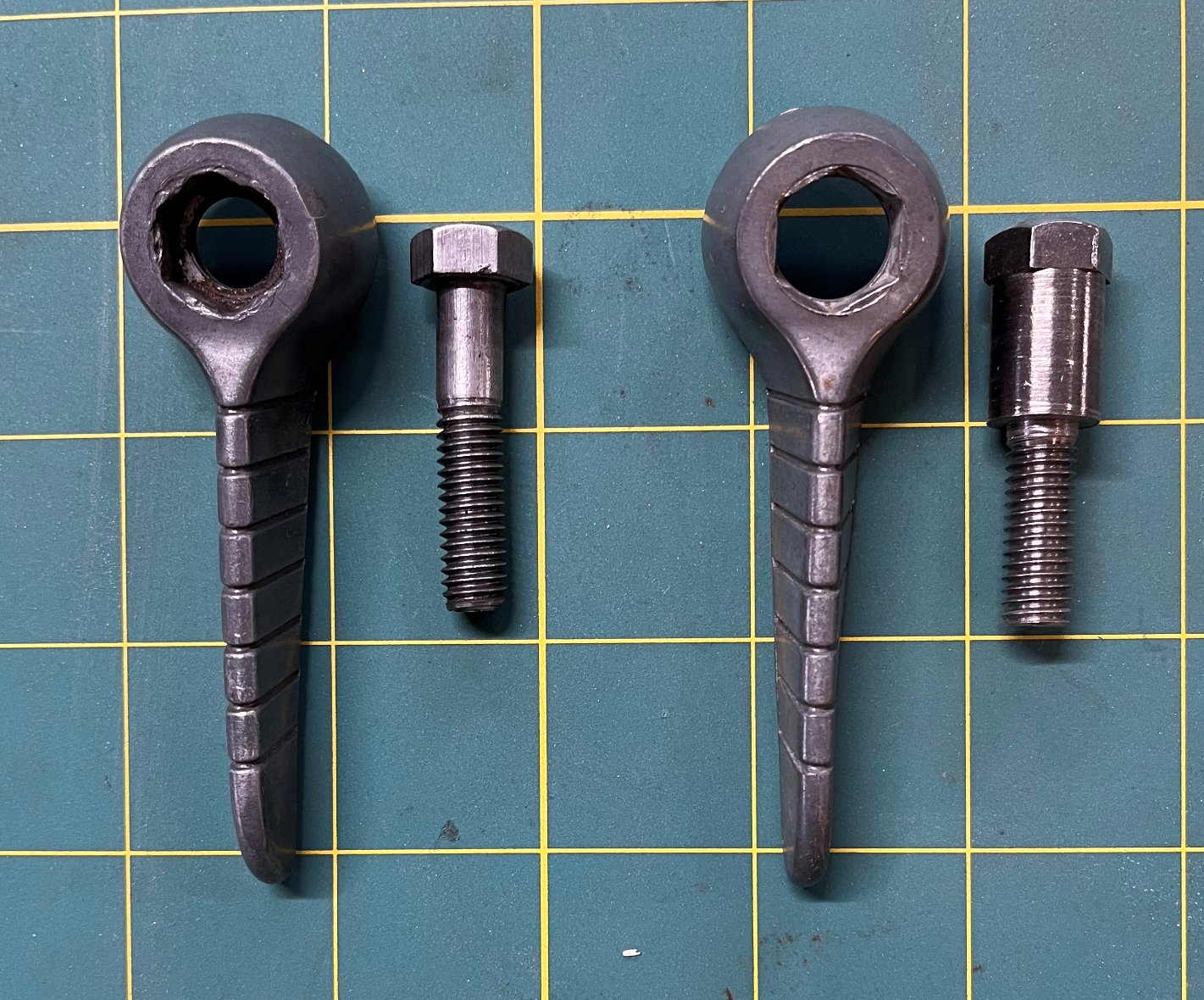

For anyone else reading this and needing additional information the earlier Jointers from the 1950's used a different Bolt for those Model 4E (made for the Model 10's) and the Model 620 Jointers. Those are shown below with their Locking Levers. The one on the left, a standard bolt, was used on the first Model 4E Jointers followed by the one on the right used in both the later Model 4E and early Model 620 Jointers. The Locking Levers are slightly different too.
