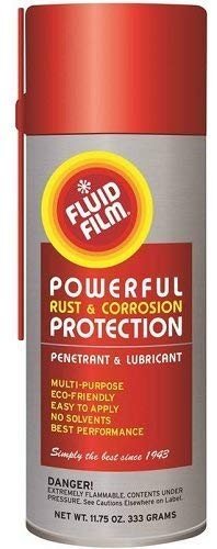

I use this stuff on my Drill mill and lathe and shaper.
I really like this stuff.
You may have to clean this off before you do Woodworking but it will save it till you get ready to use it then you can reapply it.
Just an Option, Hope this helps.
Fluid Fill Aerosol 11.75oz.
Link: https://www.amazon.com/Fluid-Lubricant- ... 0XNM&psc=1

- ff.jpg (22.73 KiB) Viewed 2881 times

Looks like what I was searching for: how to stop rust between uses, which might be for as long a few months in a damp environment. Lanolin is a great idea for such a product. Thanks
