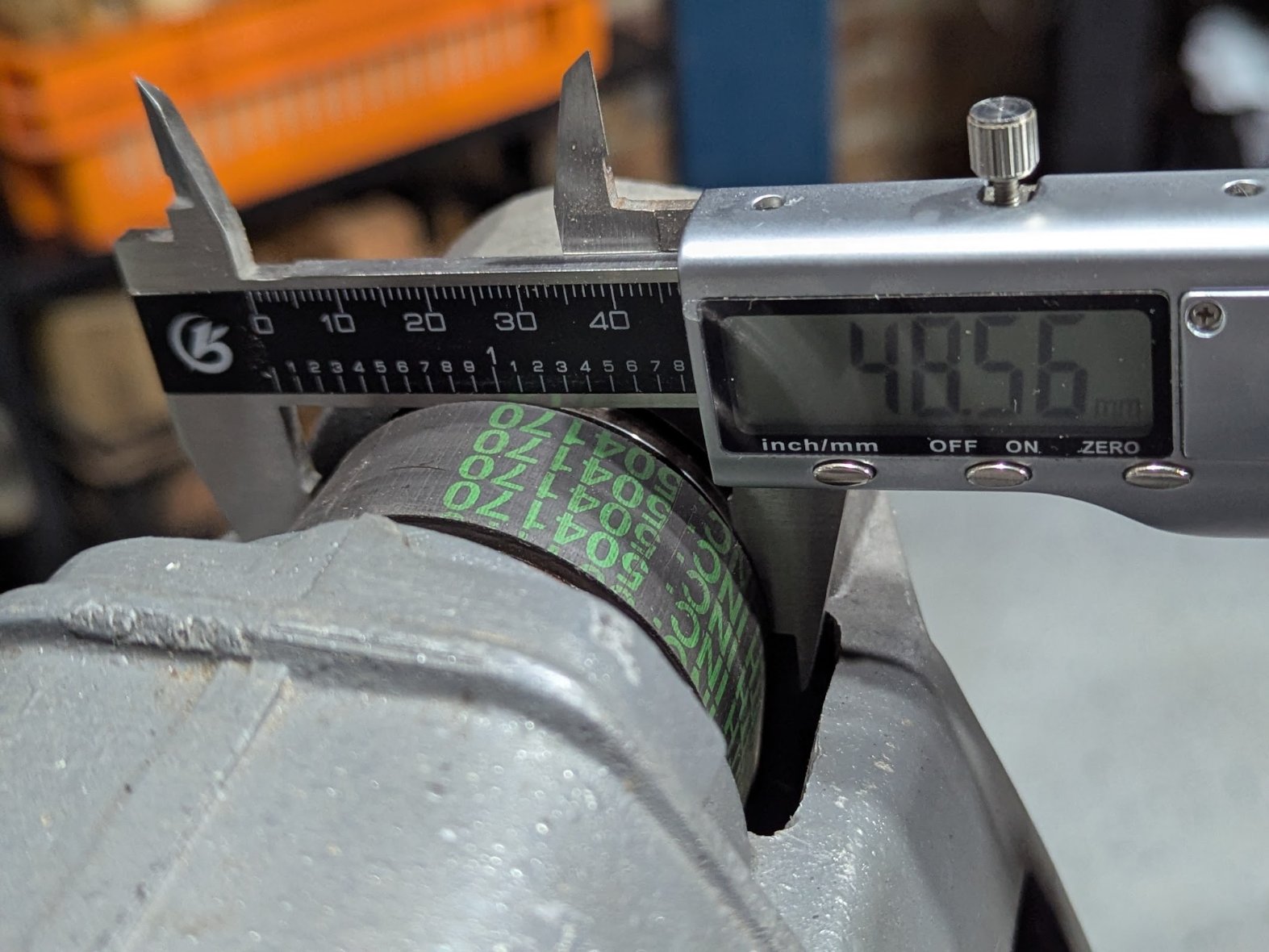

I read JPG's posts about the poly-V pulley ribs and the idler/main ratio. The OD across the rib tips of my main-shaft poly-V pulley is 48.56 mm (~1.91") (pictured). JPG eyeballed about 1-3/4" for the US version, so I expected mine to be smaller, but it's the opposite. Now I'm more confused than ever.
50hz Poly V Ribs OD.jpg (220.2 KiB) Viewed 3141 times

As for the pully od, the meaningful (non-measurable) dimension is the pitch diameter of the poly-v pulley. The od may indicate a difference. Since you actually measured yours, I presume it is more accurate than my 'estimation'. I will measure one of mine when I get a chance to do so.

I measured 48.6 mm on a sample where you measured 48.56 mm. I would call that the same as it pertains to this discussion. It is, IIUC, the ratio of the Poly V pulleys that is critical. It allows for the machine to simultaneously be set up for sawing and jointing at the correct speed for each.
