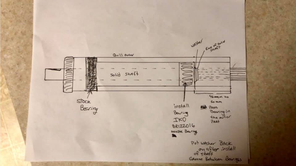

Ok so I didn’t want to spend $180 rite now on a two bearing quill so my solution (and not saying it is totally correct way to do it) I removed the single bearing quill that I was having a lot of wobble with when using it as a lathe. I installed a needle bearing just past the washer ring in the inside of the quill that pressed into the external piece of the quill. Then the shaft to the quill fit exactly inside the needle bearings. It is nice and tight now. Fixed and running smooth for a$12 bearing and some shipping. Back to lathe work now!!!!

Pics I can’t but can draw what I did.
Daniel Percell
Bearing is IKO bearing. Br122016 and you must press it into the outer part of the quill. Here is a pic of what I did and it helped a ton. Not saying totally the only way but it is working and serviceable

Understanding needle roller bearing from a u-joint application perspective I would see if I could also Press in a 1 1/4 x 3/4 rubber seal to help keep external contaminants from getting in the bearing from the spline side of the shaft
They tend to run a bit dirty and the metal sling ring was used try and keep it from migrating originally. Might could do both with a tiny gap between

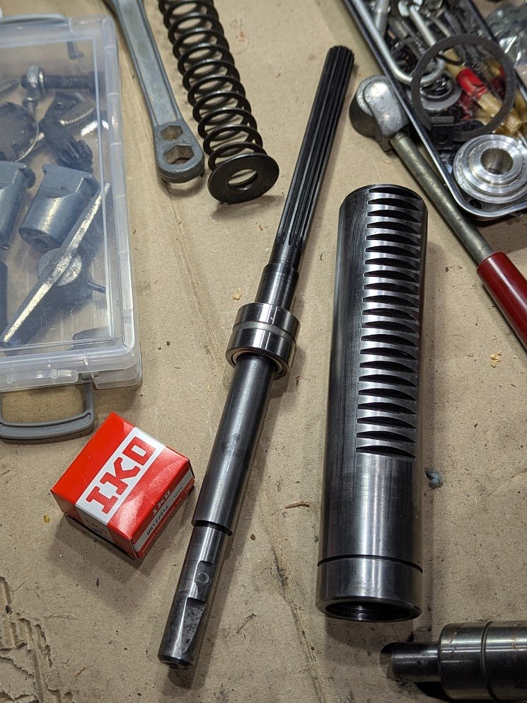

Cool idea, I couldn't find the original post, or author, but there are cheap chinese ones online, so I will get one, see if it fits at all, and if it does I can buy a real one. I checked my shaft OD and outer shell ID and it seems to be a perfect match. Could be a nice $10 mod!

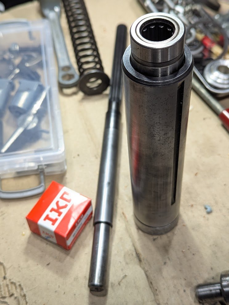

Ok mine arrived. it fits beautifully over the shaft, but there is no chance of getting it into the quill housing by hand.
Unsure if I should try my bearing pull in reverse like I did to seat the other headstock bearings.
Getting it seated to the correct depth seems like a guesstimate process.
Not sure it's worth the effort unless you really really need the tollerances.
If I had a spare housing I'd just try it, but I dont want to deform it.
I think you could hammer it out with a long lawn mower spark plug wrench.
