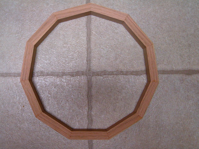

Well, a few weeks ago I broke out the segment jig and cut 20 segments, each about 3 inches long. When I put them together on the bench they made a circle a little larger than 20 inches. Having no use for that, I left it sit around for a while held together by a strap clamp. Was going to snap a photo, but spaced that out of my brain.
Thinking that 17 segments wouldn't produce a much smaller circle, (unless I fiddled with way shorter pieces) I decided on making 11 (still an odd number) segments. So using 11 of the original segment pieces, made a new one. After keeping this 11 segment piece on the bench for a while - decided to glue it together. No joinery other than butt joints. In both trials the joining edges fit very closely. It has not yet been sanded at all -so some glue marks show. Any deformities are from fumbling around with the parts like dominoes on the bench and occasionally dropping some.
The segments are almost 3" long x 1 1/2" high x 3/4". It forms a circle about 13" in diameter. It came out like this - (shown below) (Really - the kitchen floor isn't dirty - that's a shadow!)
Now I am still wondering what to do with it. I'm thinking of it as a frame. Tentative solutions are to put a clock in it - frame a picture or an embroidery design/done by my wife. I've seen that the inner bottom edge could be rabbeted and the other could be routed to various shapes. Could saw kerfs through the joints and insert splines. Could even carve designs into the outer edges. Any added suggestions?

OH YEAH, I remember that thread. Mostly for being impressed that Dick took the time to visit here. GREAT to see that it works well Chuck. Well except for what do ya do with the piece:D now?

Looks great, Chuck!
Cut an 11-sided bottom piece for it and make it into a tray. Turn a 5-inch or so bowl and put it in the middle of the tray. Fill the bowl with guacamole and the tray with chips, and you're set for the upcoming All-Star game. Bet you'd have the fanciest chip-n-dip set in Lancaster!

Chuck, The 11 sided polygon looks great and would make a real nice tray with a decorative plate set into a recess cut into the back side. The possibilities are endless, as it all falls back on your Imagination. I am very glad to see you all are still mastering many wood related projects.
