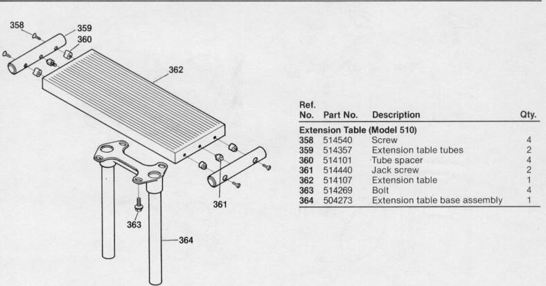

from the old service manual:
[ATTACH]5759[/ATTACH]
old ss table.jpg (36.67 KiB) Viewed 3202 times
Hi,
Perhaps a review is in order. The older (85) version rails for the extension/floating tables use a bolt drilled into the tube. The table uses a tapped hole so in order to adjust the position of the rail in relation to the table the hole in the rail had to be larger then the screw... this was very likely a pain to do with that system and called for more precision in the manufacturing process to make it work. I would also guess this is why the change was made to the current system after a single year. (The hole in the rail would have had to deal with the curvature of the tube thus attempting to be at any location other then centered would contribute to misalignment.)
On the newer version the holes in the table could be made so that a lot of room would be available for both the manufactured parts and the adjustment. In brief terms you have a lot of wiggle room.
If the hole positions are in the same location then to convert to the drilled holes is simply a matter of drill the tapped hole out using the drill ability to center it self in the tapped hole. If the hole locations are not the same then this becomes a bit more of a problem and maybe not worth looking at.
The third hole used for the jack screw also must be located to match the rail parts and must be either smaller or the same thread in both the old and new versions. If the locations match and the thread size is correct great. If the location matches but the thread is smaller you might be able to redrill and tap for the larger size... I think you get the idea right?
So no need to ream or precision drill. The table holes will be a lot larger when you are done so a few bits off will not affect anything. As far as hole size I seem to recall that it was something on the order of 5/16" but please check the main table and match that hole size as my memory has been know to glitch.
You may well have to shim either the table or tables to get things to align in the front to back position. The holes will allow you to match the height.

reible wrote: ... The table uses a tapped hole so in order to adjust the position of the rail in relation to the table the hole in the rail had to be larger then the screw...
(This is the only part that's a bit off. In these older tables there is zero-point-zero adjustment room. The screw hole in the rail is tapered to accommodate the flat head Torx screw.)
This was a key point in my worries about positions, since when all this came up I had no idea how many different variations there are, especially as relates to the 520 upgrade (never seen one up close).
But armed with all the info you guys, and Linda, have kindly (and patiently) provided I feel comfortable in going ahead with the 520 order (so I will never ever have to look at another tube rail again, ever).
